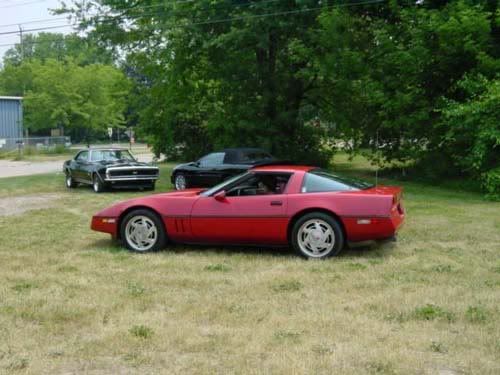

Yep, they do but only with adapters however. The Sawblades are somewhat stronger than the 87 wheels pictured . But then they steal the whole damn car if you put them on....:upthumbs
