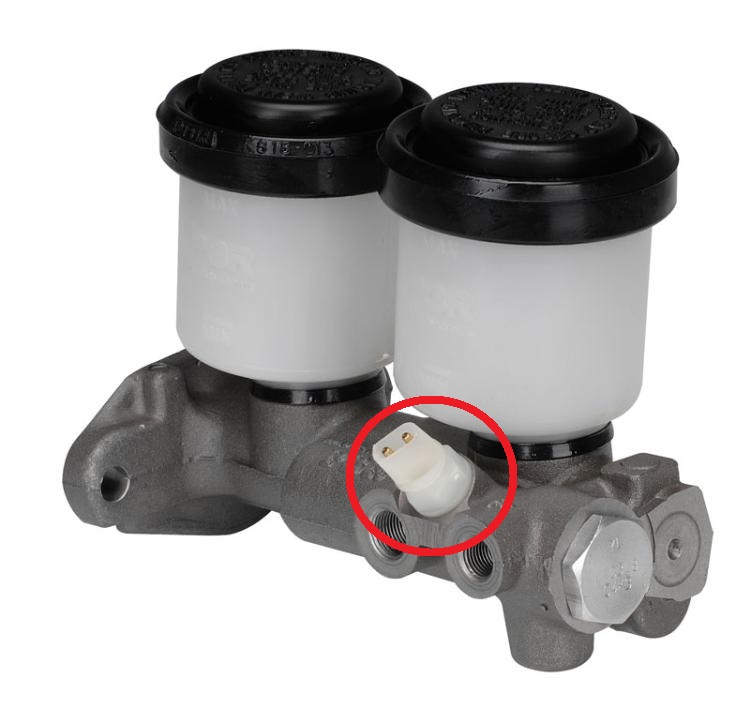

So I have the ABS fault. I have removed all of the wheel speed sensors and cleaned them, checked all of the relays that go with the ABS system, and looked at all of the fuses but the light is still on. There is a small wire that should be connected to my master cylinder, but the connector itself is broken on the inside so it wont connect properly. Would this be giving me an abs fault or should I look into the ABS computer or the pump behind the driver seat? I cant find any solid advice on this so if any of you have any help it would be greatly appreciated! Thanks! Master 2.jpg

I had the same problem on my '90 Coupe. You CAN NOT find a replacement connector anywhere. I looked. Here's what I did to remedy the situation. If you can't get the component,....then we have to make one!
The 2 poles connect as a common in the original plug. This is obvious since it is a single wire coming off the 2 pole plug. Remove the old connector and crimp on a female BLUE blade connector and spread it open a little bit to fit over the 2 pins on the switch on the master. DON'T force it. Spread the connector.
ALSO:.. The old sleeve from the original plug usually separates from the plug and stays on the pin, so you will have to use a needle nose pliers and gently remove them from the pins prior to installing the new plug.
I then pushed my connector onto the switch. Then, seal it up afterward with a little silicone to seal it to keep the weather out. Clear your code(s) and the problem is gone! Works like a Charm!
