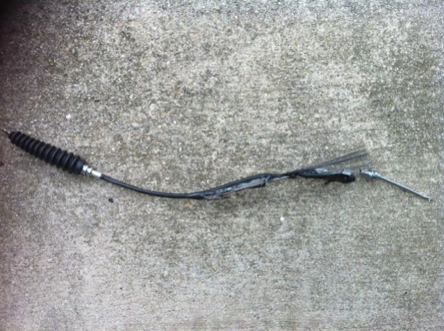

I am having a problem with my 1992 coupe... I've put about 4000 miles on it (126k total) and last Friday drove it for about an hour and when I got back in it I turned the key and got nothing (VAT has been removed). After about 3-4 min I turned the key and it started right up. I went to put it in gear (automatic) and I had no gears. The shifter cable had broke right at the shifter in the car. I also smelt something burning and after I got the cable out saw the end was melted. I figured it was from laying on the exhaust after it broke.

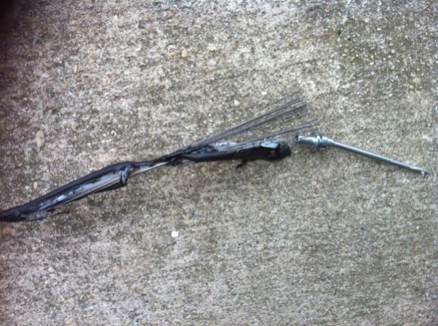

A friend and I replaced the cable and I thought I was good to go... I've put about 2 hours in total driving time on it at about 15 min at a time and today the exact same thing happened. This cable completely melted. My friend thinks the car has some type of ground problem now and its trying to use the shifter cable to ground the car. Any thought? Any place I should look first? I did check the ground cable at the transmission and I found three on the frame that looked good but I cleaned them anyway.

Here is what happened to the new cable. Orininal cable just snapped and slightly melted

A ground does not cause heat or arcing unless there is voltage present. People struggle to have enough ground path in corvettes. The engine and trans are 2 places that are desirable when adding grounds.
You have a "hot-wire" shorted out somewhere...a major source of voltage that can carry enough amps to arc and melt a steel cable.
Might want to trace the battery pos cable and all the wiring harness under the shifter cover . If voltage is using that cable to "short"...something on one end or the other has voltage that should not be there...a worse fire is possible. You should go disconnect the battery RIGHT now until this is diagnosed.
