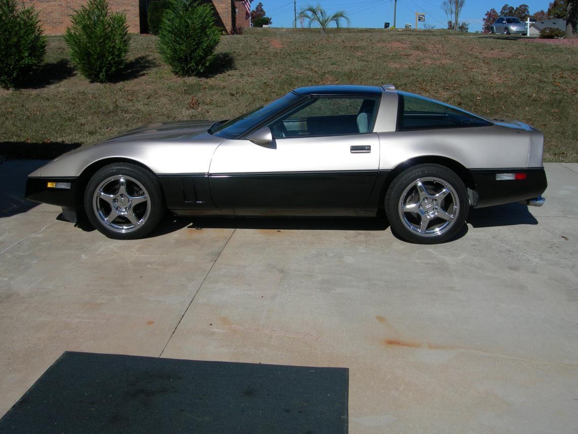

That's a pretty rare piece. I'm sure everyone would love to here details and see a picture of your rare 86.
Richmond Gear used to have a kit which allows a DIY to replace the Doug Nash trans with a Richmond six-speed.
I found the car in 1995 and it had been mistreated to say the least. Didn't really know what it was until I started refurbishing it. Most of the damage was cosmetic, although it needed mechanical healing as well.I have driven and enjoyed the car since. Just recently has the tranny started making noise. I have tried to post a picture, but apparently I'm not as computer literate as some.

The paint scheme of silver beige over black was unIque to the Konner vette in '86. There were 50 with this paint scheme to commerate the largest corvette dealer in America at the time,Malcolm Konner. There was a large festive event scheduled for each buyer as they picked up their new Konner vette in Bowling Green.It's the only time Chevrolet promoted an event of this kind for DEALER.
