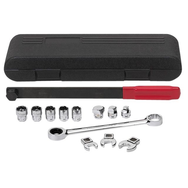

The serpentine belt is a piece of cake. BUT... in addition to the tight clearance between the tensioner & crossmember, I found that the orientation of the hex on the tensioner bolt may restrict your available motion between the air intake and A/C pipes as you try to turn it.
After trying a breaker bar (couldn't get a socket on the bolt) and a regular serpentine belt tool (couldn't turn the bolt far enough to get sufficient slack), I found one with a ratcheting head which solved both problems.
"KD Tools Geared Serpentine Belt Tool" at Sears: http://s7.sears.com/is/image/Sears/00947098000
I suppose one could remove the intake if necessary, but it's more fun to have a new tool. :D
