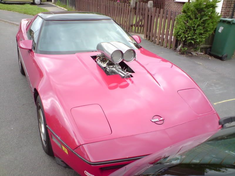

heres a pic or 2.

Not sure about the factory original part, but that is one powerful looking C4.

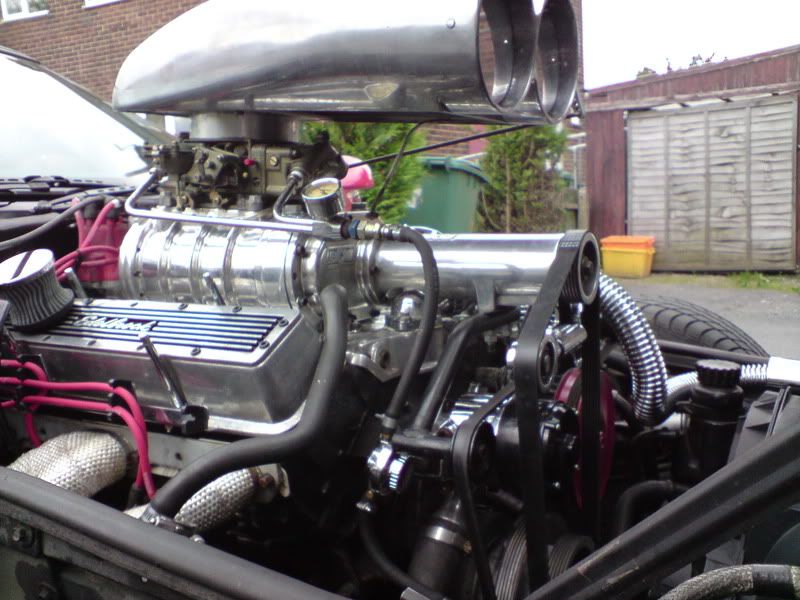

Ok here we go, the motor is a 355cui , 4 bolt mains , arp bolts in everything top to bottom, eagle rods, forged pistons, clevite bearings, 9.1.1 cr , heads were standard but have been worked by a friend and flowed, cam is compcams blower cam, compcams hydraulic followers and rockers, holley intake, B&M (holley) 144 blower, 750cfm holley vac secs with externally boost referenced PV, leccy waterpump,skyline alternator, headman 2 1/2 inch headers, and shit loads of special time consuming lil brackets and mods.Procomp race ignition system. 8mm superconductor plug wires, 2 stage cooler plugs.
Oh and Edelbrock SCREAMER drive gears :D whizzz whizzzzzz whizzzzzzzzzzz
Makes 648 bhp on the dyno at the rear wheels.at 5000rpm!

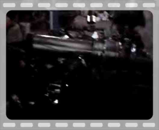

heres a lil vid of the motor when we first fired her up in the car , you need lots of volume and plenty of bass on to get the true sound.................it revs like a bike:lou
ENJOY!
