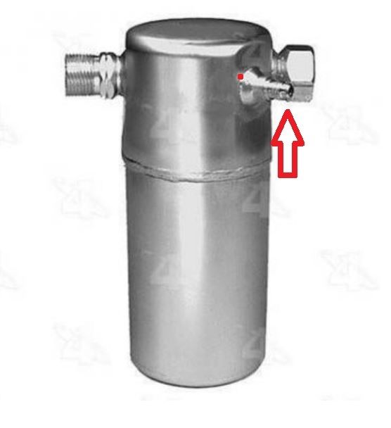

If the AC compressor clutch is not engaging you're probably low on freon.
With the engine off.
Take a tire pressure gauge and measure the pressure at the accumulator port.
There may be a black cap you need to remove.
Verify the pressure is above 50 psi.
Post what pressure you read.
If it's not above at least 50 psi you have a leak in the system and need to get that fixed.
Here's a picture of what the accumulator looks like. The arrow points to the schrader
valve where you can measure the pressure.
