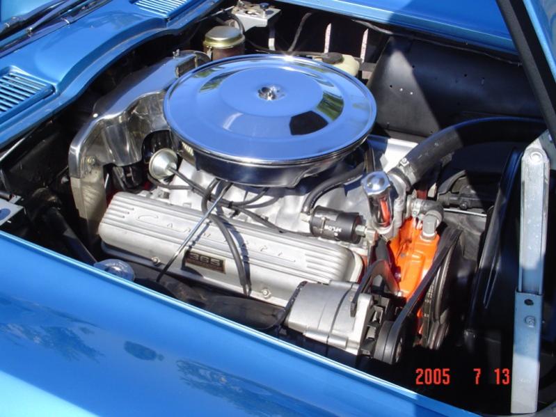

I'm replacing an original Holley 2818 carb on a 1964 327/365hp with a new Holley 1850. The only installation problem I have is that there is no allowance on the new carb for the rubber line that runs from the oil filler tube to the drivers side of the original carb. I know this allows for recirculation but how do I retro fit this? Or is it necessary at all? There is a vacuum port at the back of the new carb but the inlet is larger than the original. I would prefer to keep everything looking original if possible.

Only the original 2818's had the orifice and elbow on the driver's side for the crankcase ventilation system. There are two ways to restore functionality of the PCV system using an 1850.
1. Use a 3/8" hose from the nipple on the oil fill tube to the 3/8" nipple on the base of the 1850, using an in-line PCV valve in the hose.
2. Use a '66-'67 oil fill tube, which has a threaded bung instead of just a nipple. The '66-'67 screw-in PCV valve (#CV-726C) threads into the bung, and a 3/8" hose runs from there to the 3/8" nipple on the carb base. Use a black spring clamp at both ends of the hose. Photo below shows this setup, same as '66-'67 production.

Thanks JohnZ
Perfect answer and the picture was a great help.
