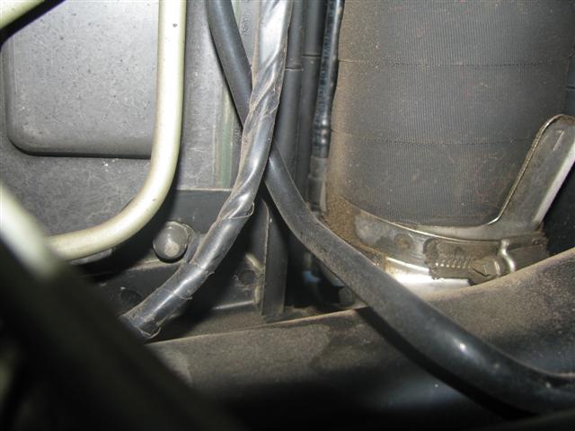

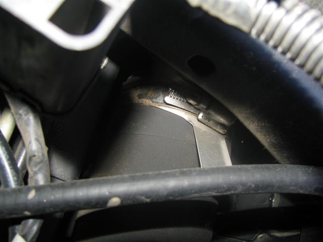

In my experience,Miles isn't the problem,Age,CornCob Fuel,Shrinking Plastic and Rubber is!:thumb
I've never had to replace a tank though,Just loosen reposition and re-tighten the Rubber Coupler at each end of the crossover tube between the tanks! I've repaired several C5 tank leaks,not found a problem that I had to replace a tank yet! (Not saying it don't happen though,I've heard of a couple on 04's that was replaced under warranty!)

Fuel tank leaks, 2 DIFFERENT SYSTEMS!
HI there,
If I may, this discussion is covering 2 completely DIFFERENT fuel systems and I believe that this is where the problem lies.
In midproduction 2003, there was a complete fuel system design change, called FFS. From production 111542 in 2003, there was no further usage of the rubber crossover pipe and clamps.
The original poster states the vehicle is a 2002 ZO6, and the special policy that HIB speaks of is for 2004 WITH the FFS fuel system.
In the pics, those had the rubber fuel crossover.
2 different systems with SIMILAR complaints.
These should be understood.
Allthebest, Paul

HI there,
Allthebest, Paul

HI there,
Personally, having serviced both systems, the following is what I have noticed.
FFS fuel systems are very DIFFICULT to work with. The largest reason I see for the cracks in the FFS tanks is the FORCE exerted to seat the 'twistlock' connections at the tanks. The new design tanks did have thicker plastic area thus dont have the problems.
PRE FFS systems are much easier and do not require removal of the driveline to repair them.
Certainly, I agree with the poster above, I WOULD WANT TO SEE the fault, what cracked and be shown how they came to that conclusion.
Pre FFS systems are more a victim of loose clamps, incorrectly seated transfer lines between tanks or leaking fuel sending unit gaskets.
Allthebest, Paul
