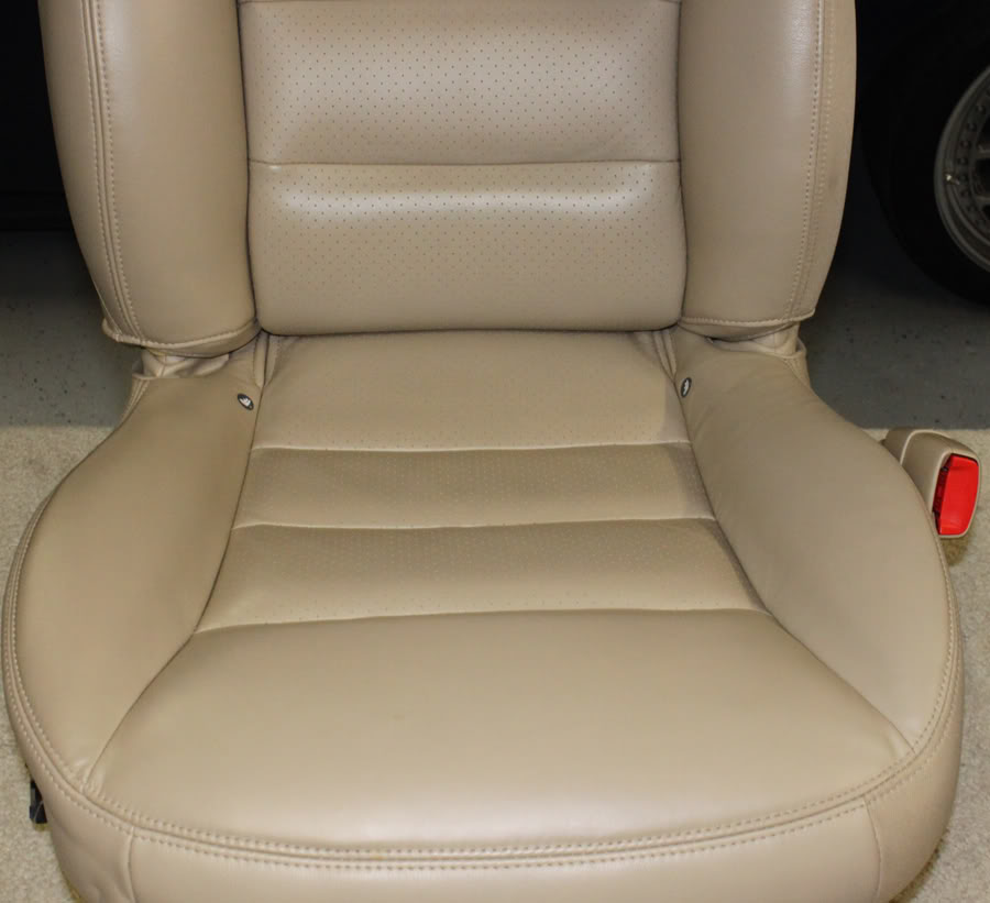

Here are the photos of a recent rebuild on my C6 seat. The C5 and C6 seats are basically the same under the cover. The information below is just the high points.
After removal of the seat, the bottom cushion is removed and ballistic nylon and high density foam added.
If you want a firmer seat, then add the jute to the center section.
Finished seat ready to bolt in.
Finished. Notice center and side bolsters are like new.
