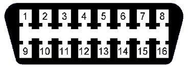

My other suspicion is a bad O2 or another sensor, but sensors in general aren't chaep, so you want to diagnose that before you start buying things. WhalePirot is right, until the engine goes into closed loop (which happens when it reaches normal operating temperature) it uses reference values programed into the computer. Which leads me to believe this is a sensor issue. Sensor issues are much easier to diagnose if you pull the codes from the onboard computers. The proceedure ecss references is spot on correct to get the codes. Since you have the FSM, you can read the full proceedure there. It tells you how to do it in the second volume. Section 8 shows you how to pull codes, as I recall. I can look in mine and tell you the exact page number if that would help, just not at the house at the moment.
There are four "computers" in my '95, a CCM (module 1), the PCM (module 4), and two more I can't remember this second (they are module 9 and A, I think ABS and ASR). Anyhow, write down any codes that you get and share 'em here. Note that code C12 from module 1 means a clean test of the CCM (so, it's normal to see C12, we don't need this one).
