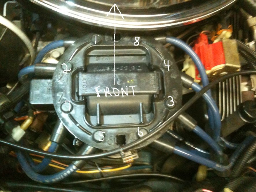

I recently replaced my plug wires, I did remove the starter for better access to the shielding. After doing some research I learned some valuable information:
1) Remove the boots off of the ends of the wires on the distributor side to make routing them a breeze, just get a small screwdriver, slip it under the boot and spray some WD-40 in it and the boot will slip right off.
2) The longest plug wires are #2 and #3, because they have to cross in front of the distributor, next is #4 and #1. #5 and #6 are the same then #8 and #7.
3) Just a little diagram I drew for doing my wires. Hope this helps as much as it helped me. :thumbs:

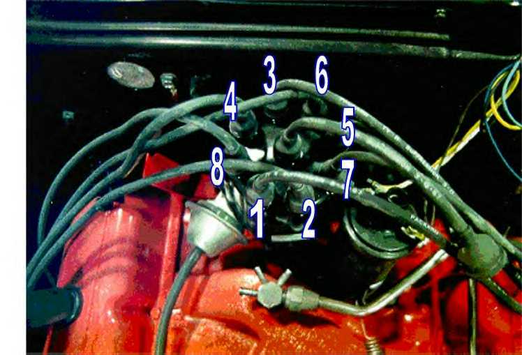

Unless '81's are different, I don't think the wires are presently in the factory original positions. Number 1 should be where you've got number 8 and so on:
Correcting this would also require removing the dist. and turning the rotor one position so I'm not sure if it's worth the effort.
I always learned get the dist. in so number 1 is facing cilinder one (when cilinder one has just started its power cycle). So the top picture is right to me :)
Greetings Peter
imagesCA0D469U.jpgThese pics are exactly how my distributor is positioned.

Wire position change in 1975 with the introduction of HEI.
