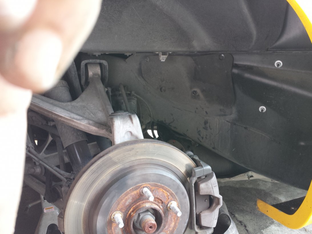

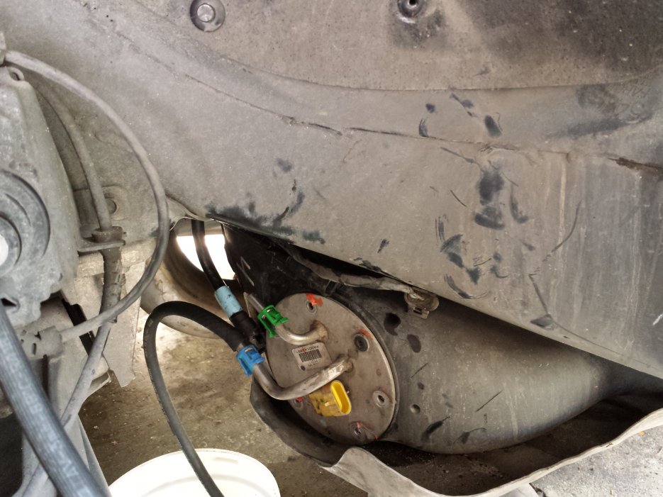

UPS dropped the new pump, so I went ahead and decided to tackle it myself. I was really surprised at how easy it actually was.
1. Disconnect battery
2. Remove Left side coil cover and depressurize the fuel system. The fuel rail has a screw off cap with a Schrader valve, like on tire valve stems.
3. Jack Right Rear, remove wheel.
4. Remove the 10 or so 7mm screws that hold the inner fender cover and remove.
5. Remove a 10mm nut and a 12mm bolt holding the rear part of the fuel tank shield.
6. Uncap the two fuel lines, disconnect the wire connector, and the 6 7mm screws holding the pump housing from the tank.
7. Remove fuel pump/sender
8. Install new fuel pump/sender using new shear off screws included with fuel pump/sender
9. Replace fuel tank shield, inner fender, wheel, and reconnect battery.
10. Turn key to On position, but do not start for 10 seconds, check for leaks.
Here are a some photos I took myself. My hands were so grimy I wasn't able to take more photos.

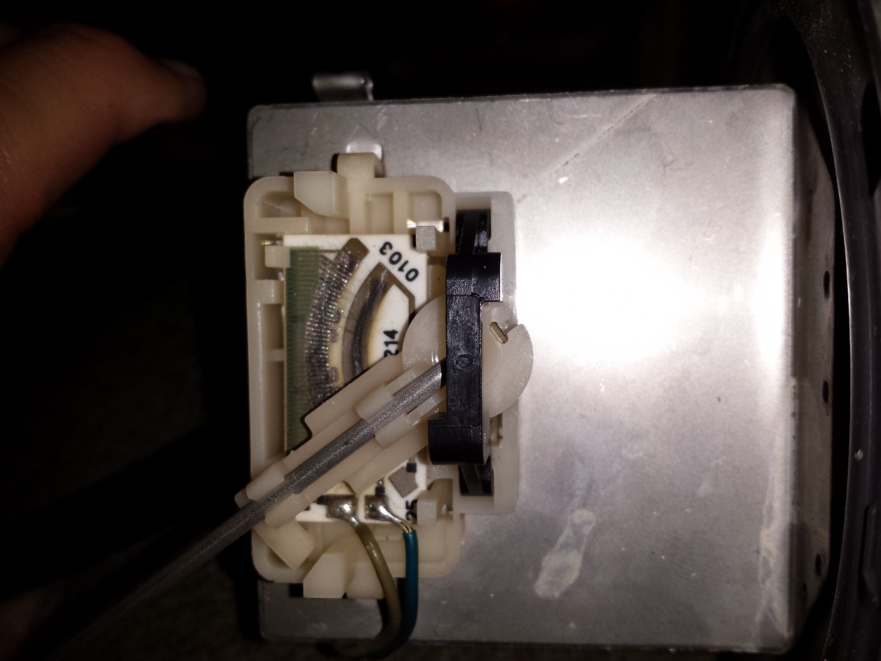

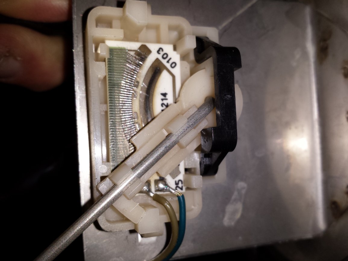

I spent some time looking at the sender part. I scraped some of the deposits off of the contacts and checked it with a multimeter. Before cleaning, it read very erratic, but after cleaning it worked as new. In hindsight, maybe a good cleaning of the metal contacts is all that is needed with some emery cloth. It took me about 3 hours total, which was the same time the dealership estimated. It would have been less if I had less gas in the tank. I had to drain 4 gallons of gas that was still in the tank.
