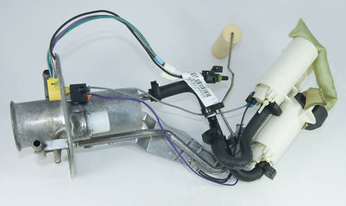

Heres a pic of your 2 pump system....its similar to my sender/pump but a little larger. you might need a more square container to use as a 'well' so the float arm can clear.
I also used stainless wire to make attachments to avoid rust and still have some strength. Tie straps get brittle and break when submerged in gasoline. Your access to the pump assy is the same...removing the gas door panel. 4 torx screws and you;re there.
