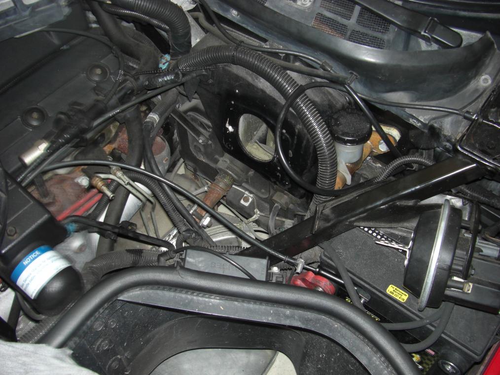

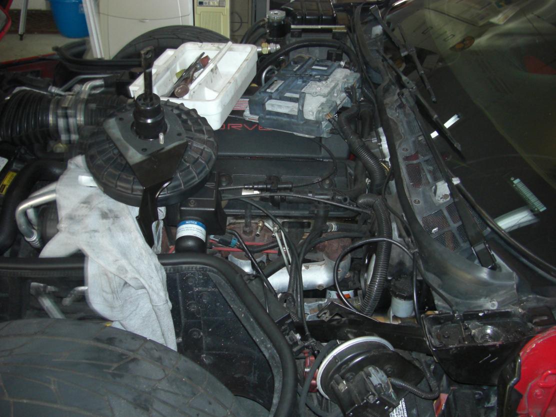

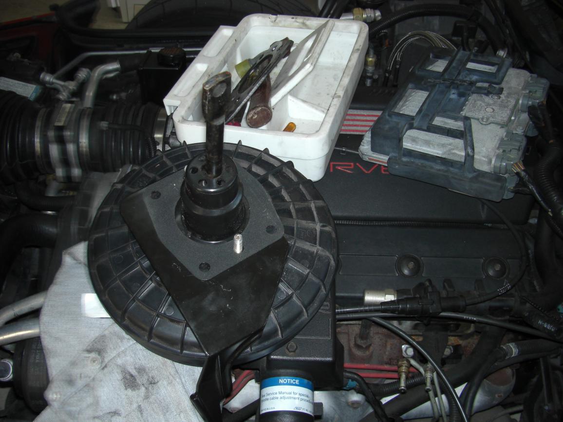

Yes master cylinder out and off, then the cable from cruise control and its really tight to get the booster unit out due to a cross member or frame bar coming at a 45deg angle.
Under dash there is a "U" clip to remove to separate the push rod from the brake pedal and two nuts that actually hold the booster on to the firewall getting them of I needed a 13m socket with universal joint to get to them. The unit then come out with a lot of cussing.

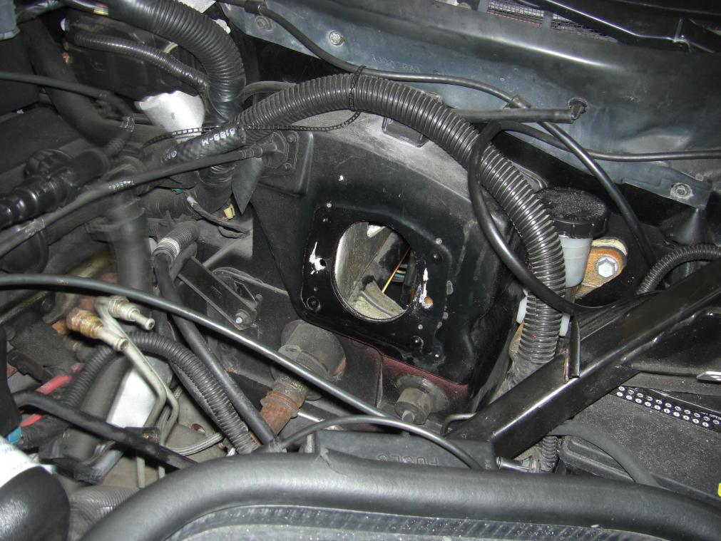

Instillation was more difficult due to the reinforcement bracket that backs up the fire wall that the booster trubolts, It moved up partially blocking the holes stopping the booster with new bracket from going back in. I used a wooden wedge under the steering column and a decent tap with a hammer on the wood and some tapered dowels to open up the holes for alignment (all done upside down of course) then wrestled with the booster to get it back in. Once that was done the rest was rather easy reconnected the hose and bench bled the master cylinder that all went in ok and a friend then hand pressed the brake pedal and I cracked and bled the pipes on the master cyl and have a great brake again.
There was no need to remove the complete brake pedal but its all very tight in there. Drop light and mirror of course is needed for familiarity and removal of the under dash carpeted panel. Going back in I used plumbers putty in socket to hold nuts in place in socket for installation.

Yes you could cut one at say 90 deg and one at 45 deg or simular however you would still need to go thru the original removing process any way. on my pict you can see where ive scratched the paint arround the holes trying to pust the unit down also you can see where one hole outboard is blocked by the steel suport inside.
Ray
