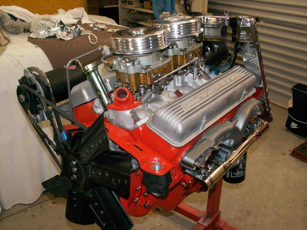

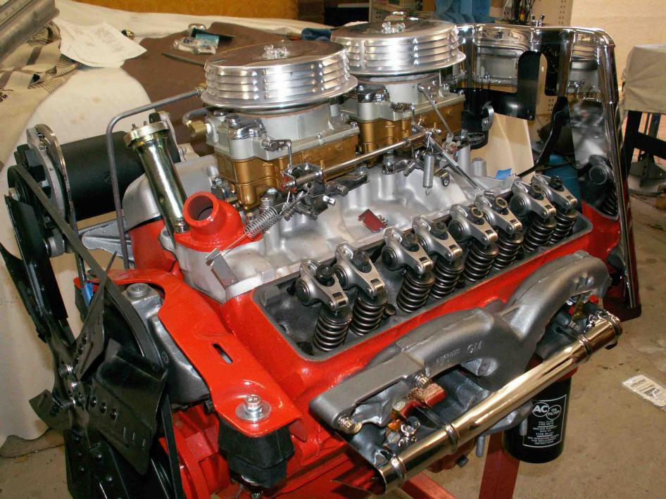

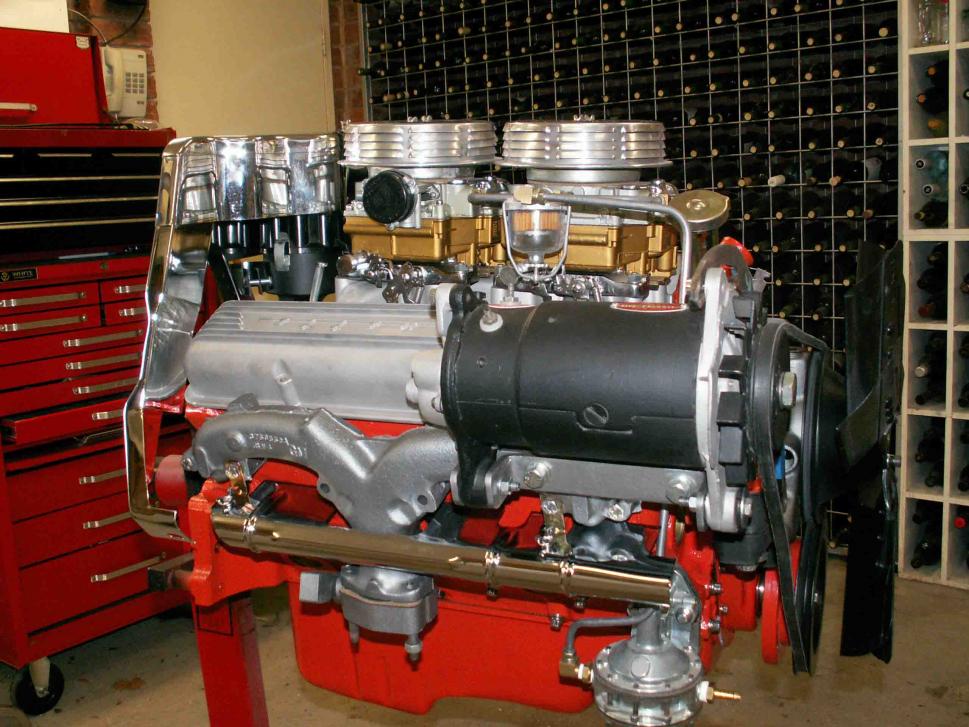

just a couple of pics updated for those interested:):)

Nice!! What brand of rocker arm are you using? I have wondered if it was possible to get roller rockers and posi-locks under Corvette valve covers. Are there any clearance issues?

They are Comp Cam Pro magnum roller rockers , machined the base of the posi locks to remove 6mm and that gave me a clearance of 5mm to the standard rocker cover even without a gasket in place, slightly shorter pushrod to set my roller geometry correct and presto very happy with the outcome. Hope these can help others cos I could not get any info on this set up.:beer
