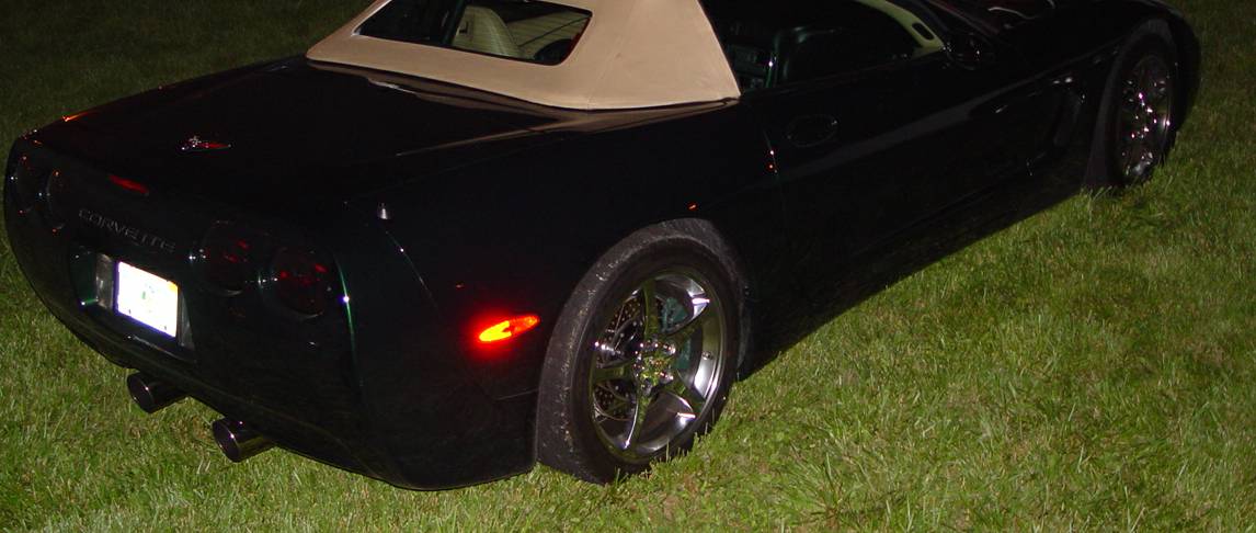

Hi MeekRN -
One of my friends from another forum put front calipers on the rear of his C5 vert.
It looked cool, but he had some small hassels modifying them to fit.
You can make out the larger front caliper mounted on the rear in this pic
You would have to use a proportioning valve to set the system up so the rear braking would be in harmony with the fronts.
