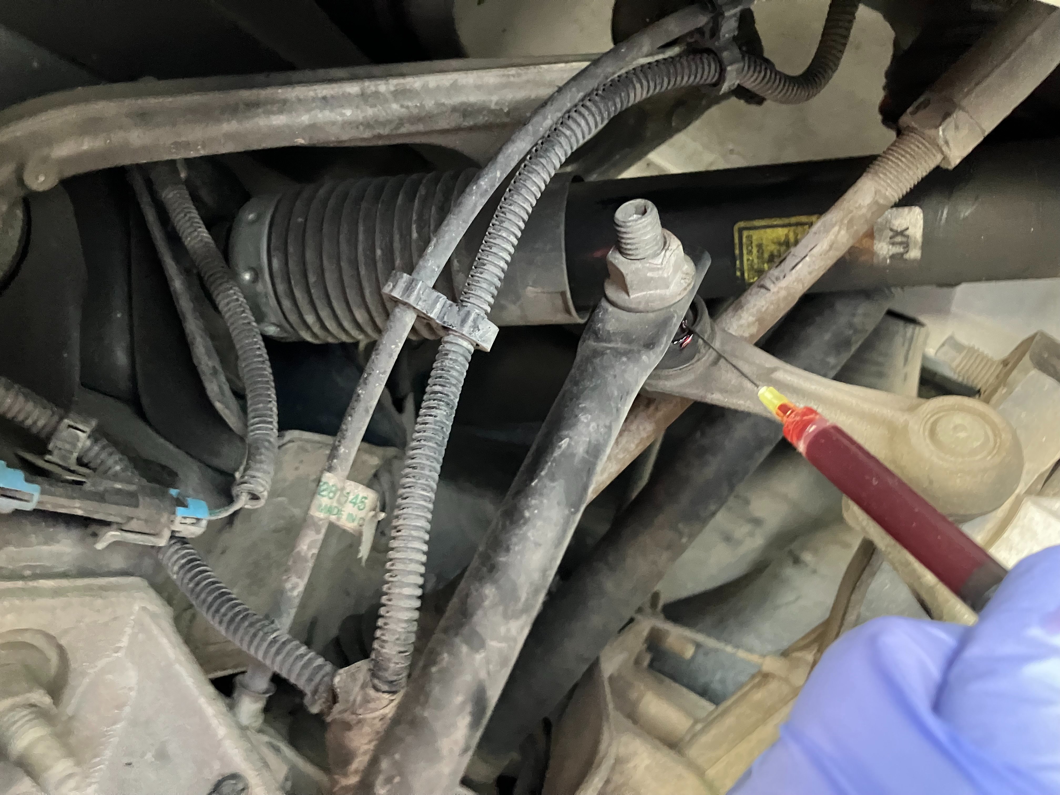

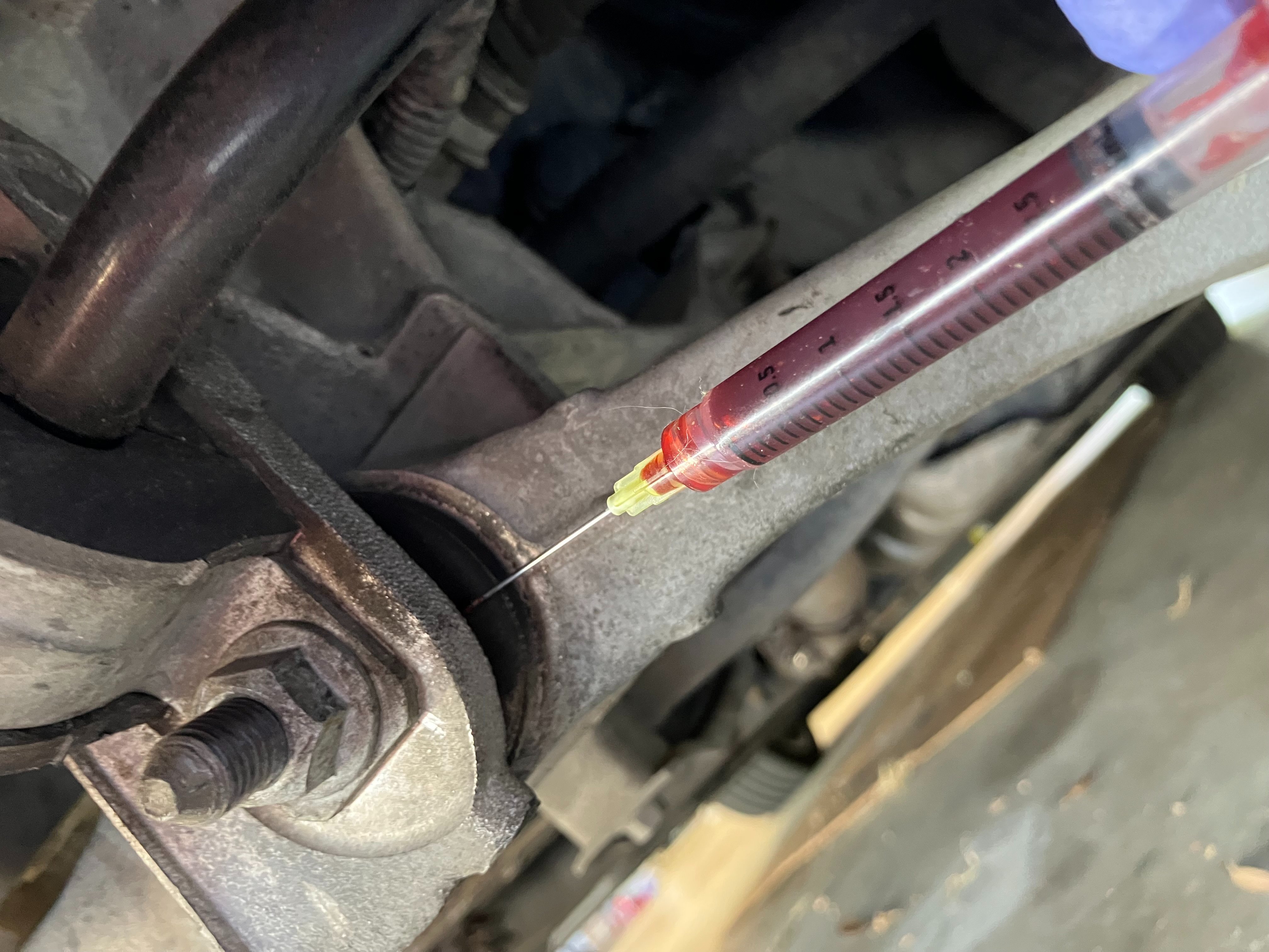

I was under my C6 that has 96,XXX miles, looking at all the hinges, steering joints A-arms, spindles and thought, "Hey, why doesn't anyone ever lube these areas?"

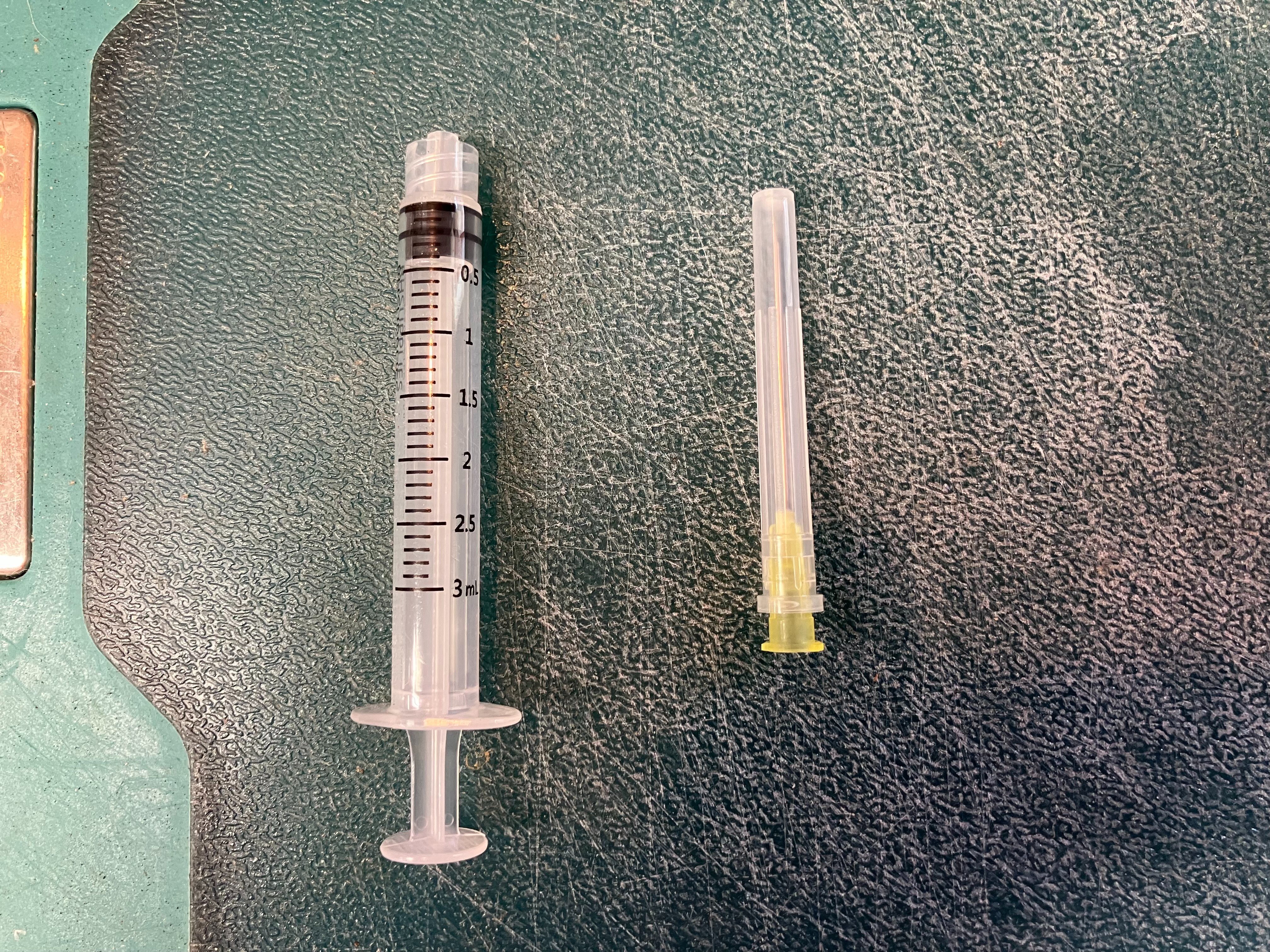

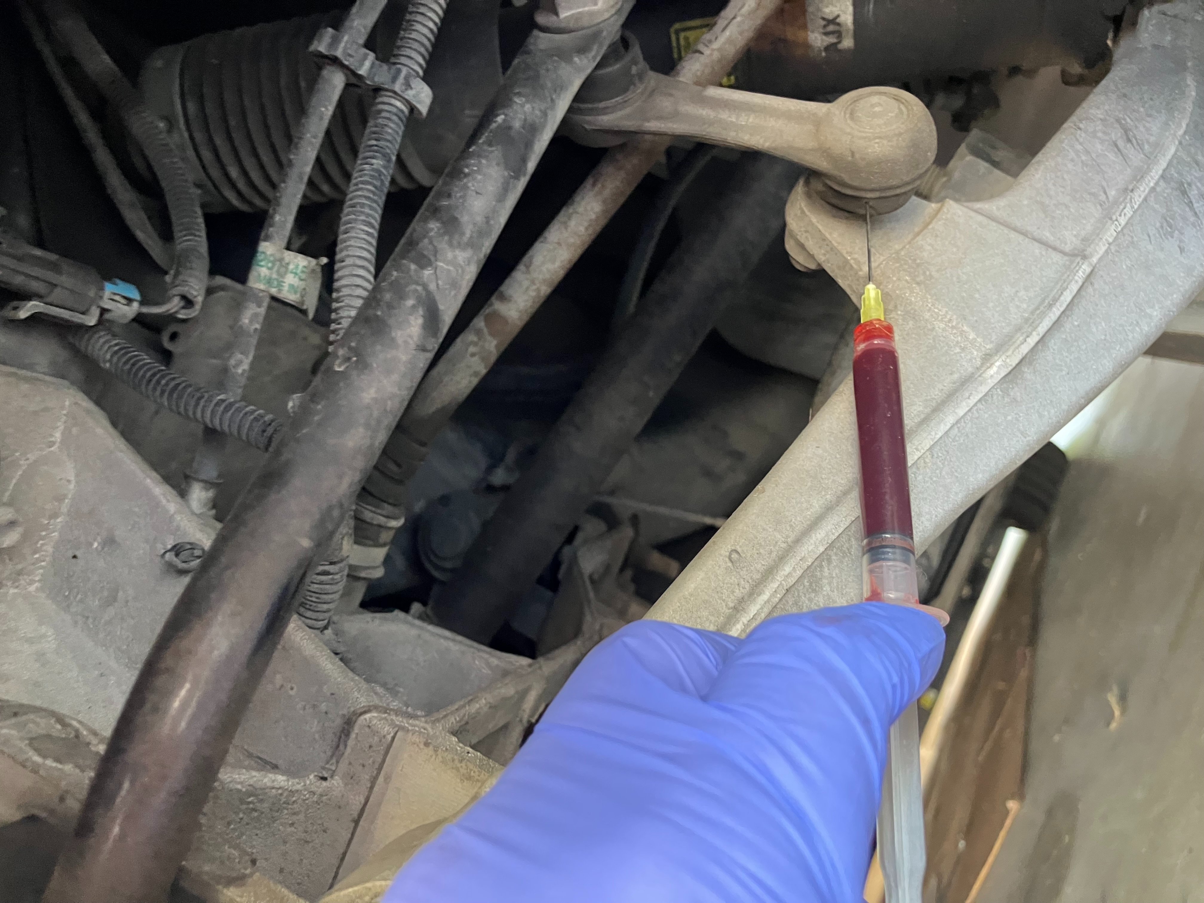

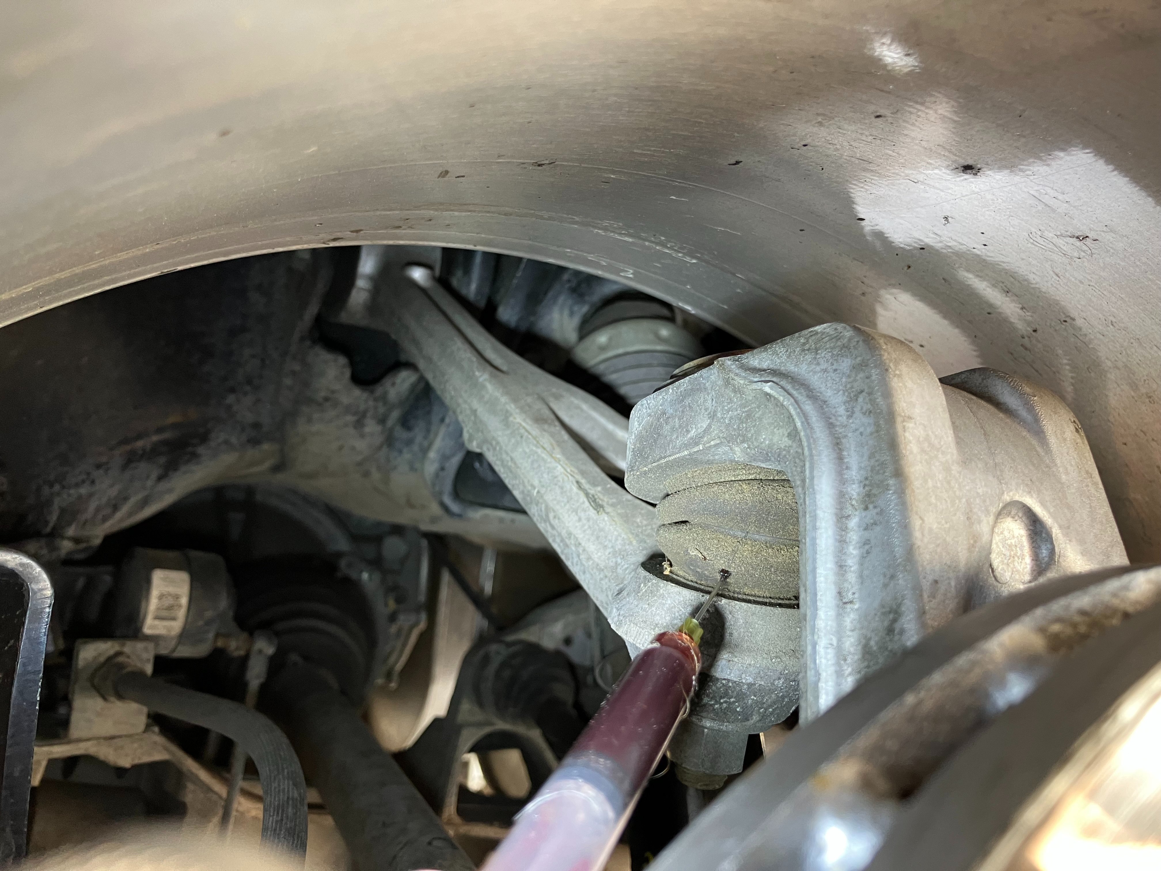

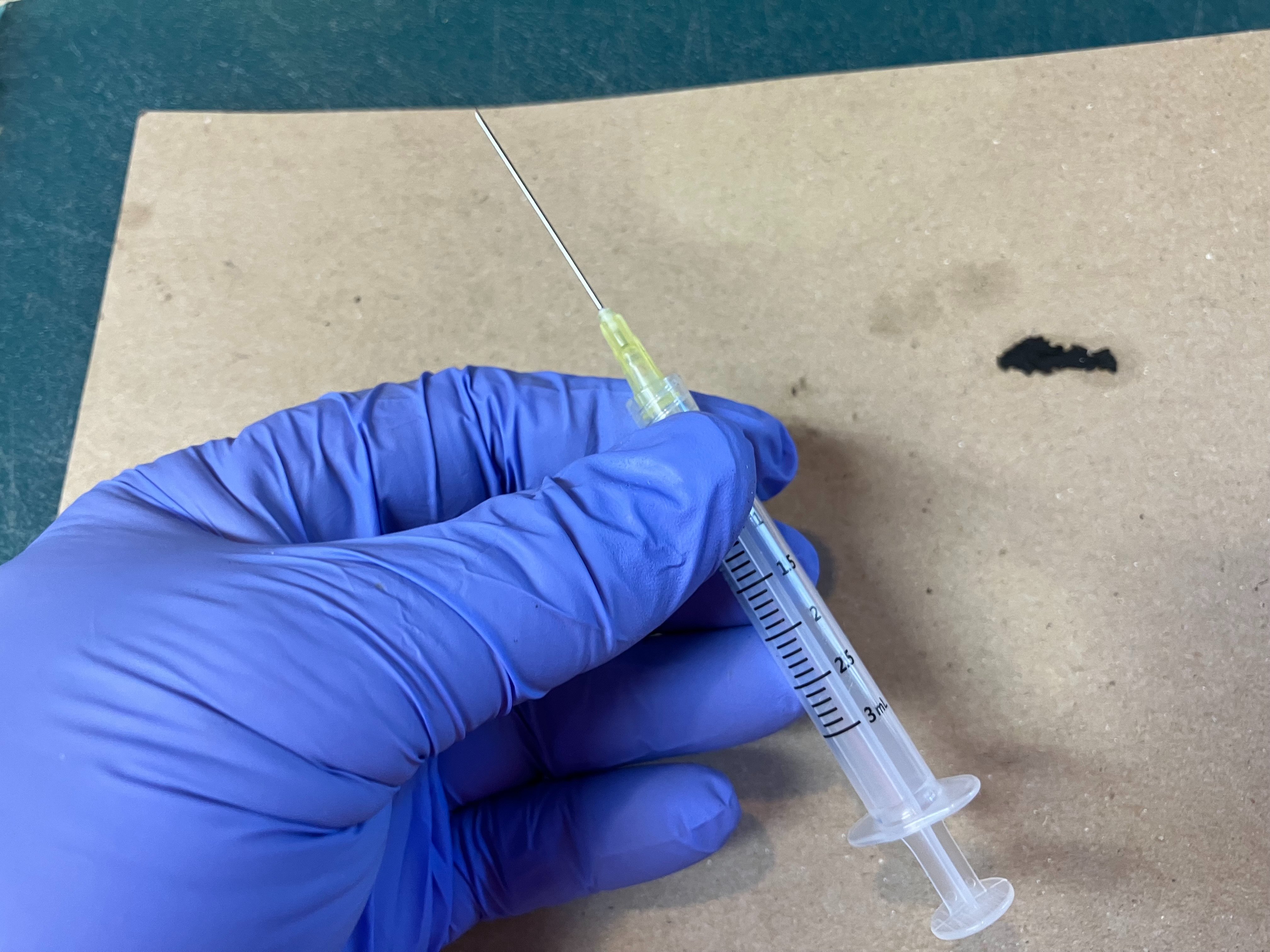

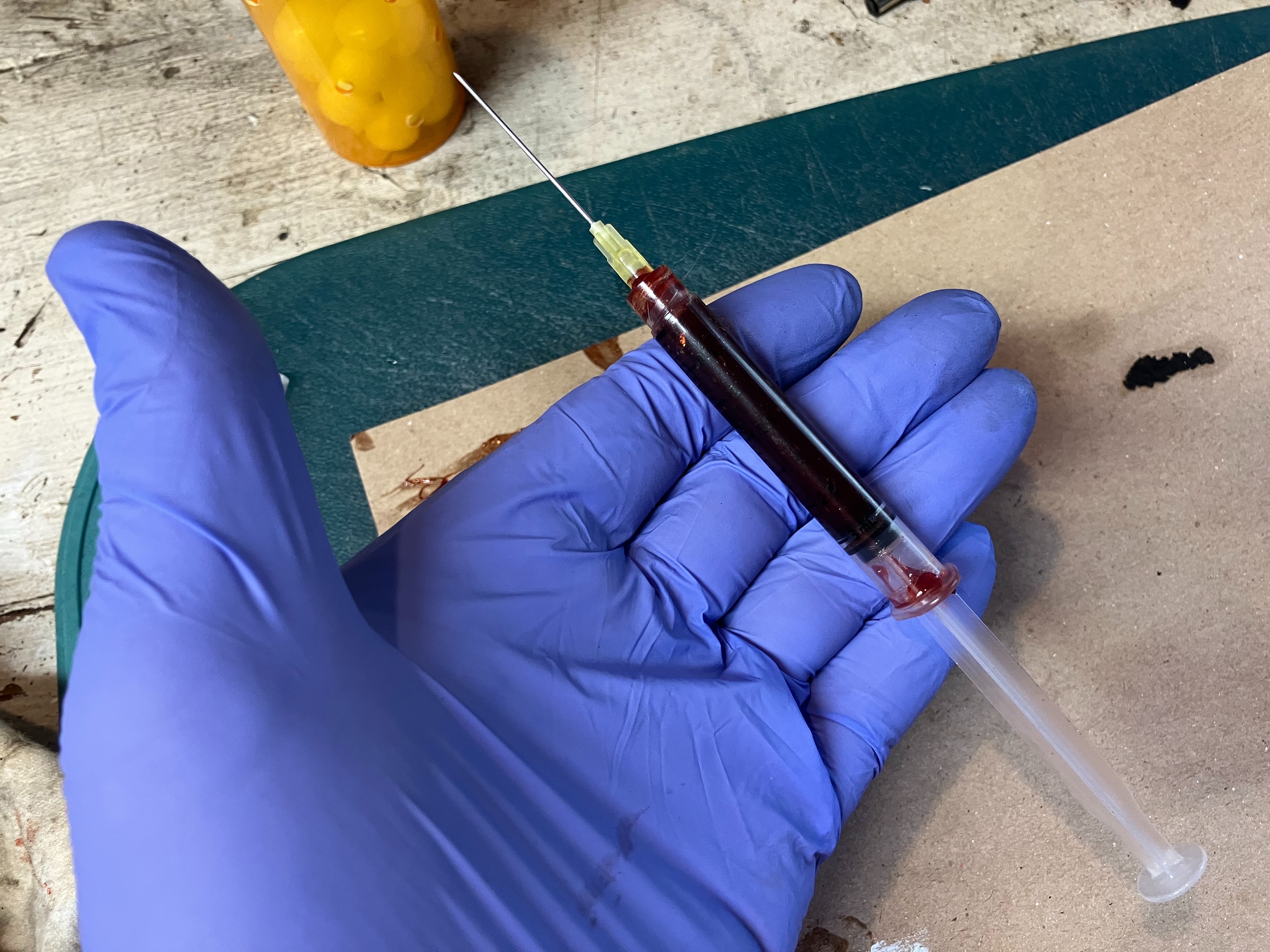

With this in mind, I got a syringe from a diabetic neighbor and thought I could inject grease directly thru the rubber bellows, lubing the joint.
Here's what I used...

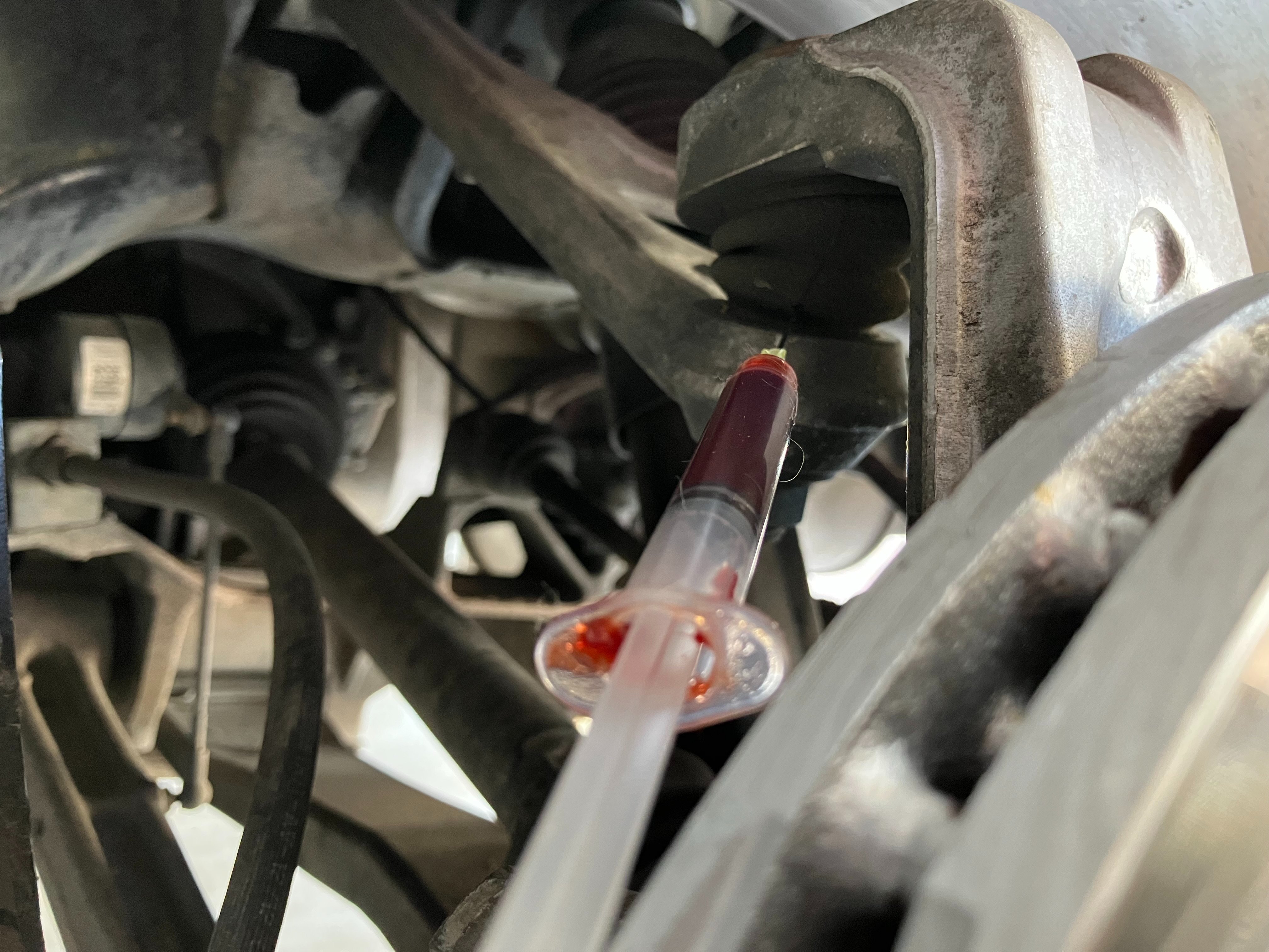

Gotta really push hard to get the grease to flow, but it works.
Don't know if it'll make a difference, but it's more lubed now, than it's ever been!
The grease I used is Red-I #2 (NLGI)

Since I posted this on another site, it's been made clear that I'm no pioneer on this. It turns out there's already a grease gun/needle tool available, just for such uses. And, it's zerk fed.
I did use my syringe on my car, and I think I noticed less stiction from the A-arms. Probably more psych than anything else, tho....oh, well.
