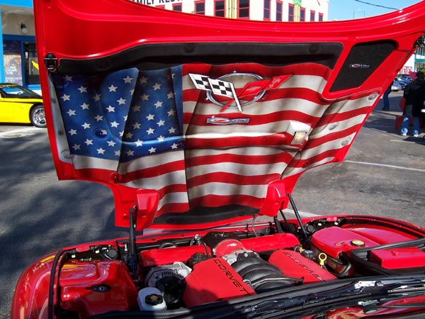

Doing a few searches . . . no luck yet . . .
this 1 looked pretty cool . . .

I would say heat, I was looking at the picture that 6 Shooter posted and it looks very cool. But I don't know if you noticed. But it looks like the paint job was actually made over the insulation. If you look close enouph you can see the
Hood Insulation Retainer and clips.
So that give me an idea. I think I will buy a brand new insulation, new retainers and clips and maybe glue the polished stainless all over it.
