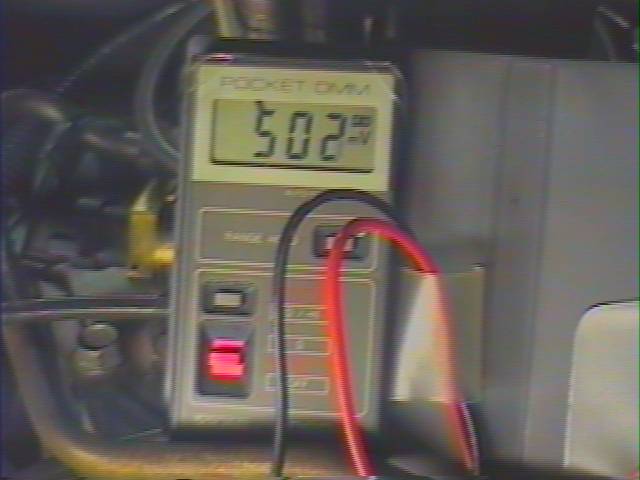

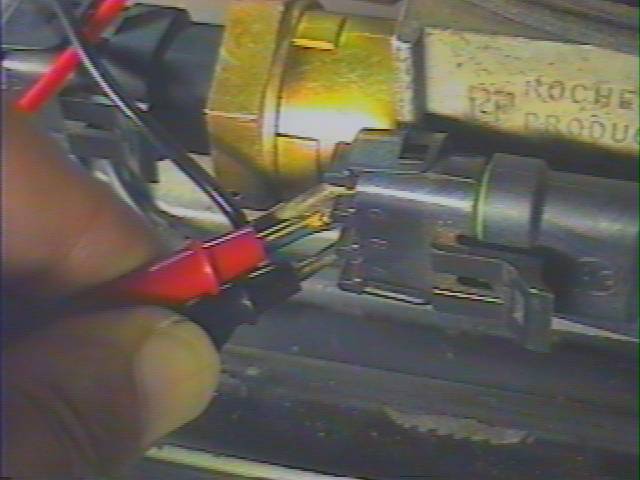

5) Check the TPS (Throttle Position Sensor) voltage with the key on, but the engine not running. It should be 0.525V + - a few millivolts with the throttle closed. See pictures: (Note* second picture is with the connector unplugged. You will need to make some extender wires to get the voltmeter leads on the connector pins to check it while operating.)
