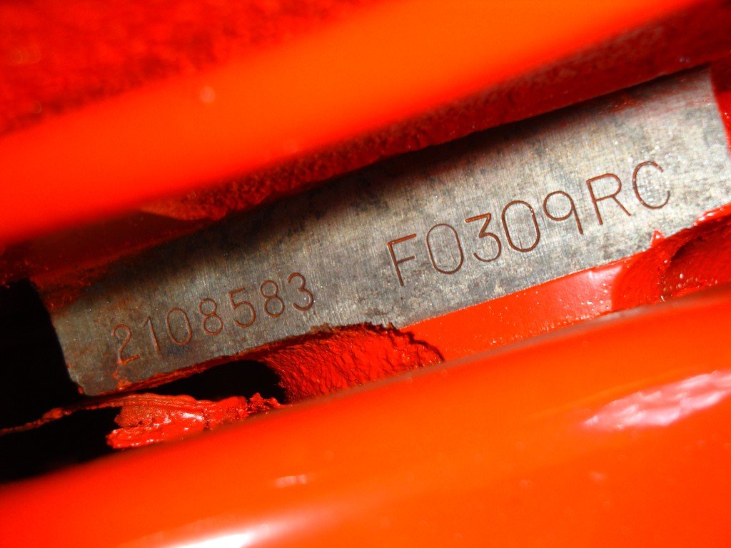

The 'S' code, being only a single character, is a dead give away that it's not from a Corvette of any year. All original Corvette engines had a two letter code until 1970 when three character codes were introduced. The pad on a '63 would also have a derivative of the car's VIN stamped next to the engine ass'y info and look something like this example.
Cars in '63 other than Corvette didn't have a VIN derivative stamped on the pad.
