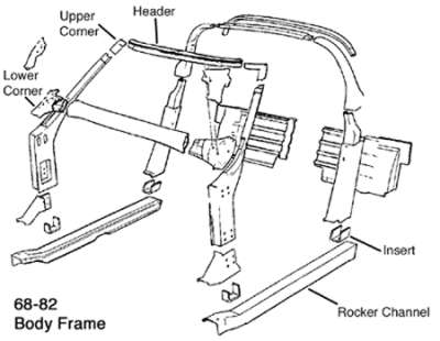

I'm nowhere near Milwaukee, but I can suggest that rust is your enemy...yes, even in a Corvette!
For all midyear and C3 Corvettes, check for birdcage rust and frame rust. The birdcage is the metal cage completely surrounding the passenger compartment and covered by fiberglass, like this:
The windshield area is a common problem. Look for evidence of flaking rust having fallen below the door hinges or under the dash, etc.
Example: Bird Cage
