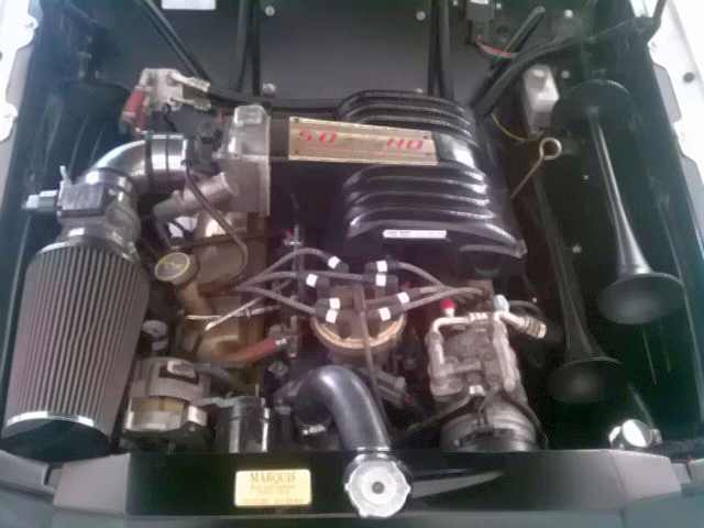

no fuel press change; parts seem ok
Odd issue, here, which may be a sticky diaphragm in the FPR (non-adjustable).
-Fuel pressure w/ vacuum hose pulled is proper; that vacuum reads 22psi; about right.
-Using a hand vac pump attached to the FPR, it holds vac pressure perfectly, but but minimal FP drop.
-The FPR is stock and nearly new (doesn't mean it's good).
-The engine idle changes a small amount when reconnecting the vac line, and the FP drops 1-2 #s. Too little, I think.
The drive symptoms are a lack of power, say at 60mph, when accelerating and there is a whining noise, kinda like a vacuum leak. The car idles and drives great otherwise. It may run slightly rich, which is proper IF the FP is not regulated at high vacuum.
The FPR feed hose is new vacuum line and has no fuel in it, nor is there any fuel smell.
It seems either the pressure gauge is wrong, or the FPR sticks and does not regulate pressure properly.
thoughts?
