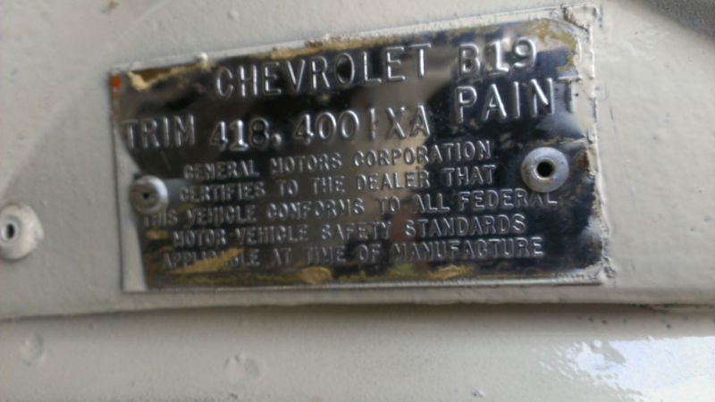

73vette5.jpgHi,
My '73 vette ( previous owner had it for 35 years), has the original trim tag which reads as follows:
TRIM 418
PAINT 4001XA
I have searched all over and cannot decipher the paint code. Any suggestions on how to decode this? Also, does someone know what paint color '4001XA' represents on a build sheet? I do not have the sheet, but I am trying for a long shot here!

418 is dark saddle vinyl upholstery. I've never seen the 4001XA code.

That's definitely a new number on me....let me see if I can find out!!!
4001 in 1973 is the paint code (chev truck) Clematis Blue
Maybe a paint to order car?
i10fwy
4001XA is a COPO billing code for "special paint"; could have been primer or another GM color not available on Corvettes. It would also appear on the original window sticker and tank sticker.

John,
Thanks for the reply. Can you pls provide the source for this info. ? Just for added documentation, if it turns out to be true after further research ( If I am lucky enough to find build sheet etc)
you could look on top of the gas tank for the build sheet.
that's where a lot of them were put..
BUT be VERY CAREFUL with it as it is probably very brittle.
you may have to remove the tank,take a picture of it and replace the tank.
