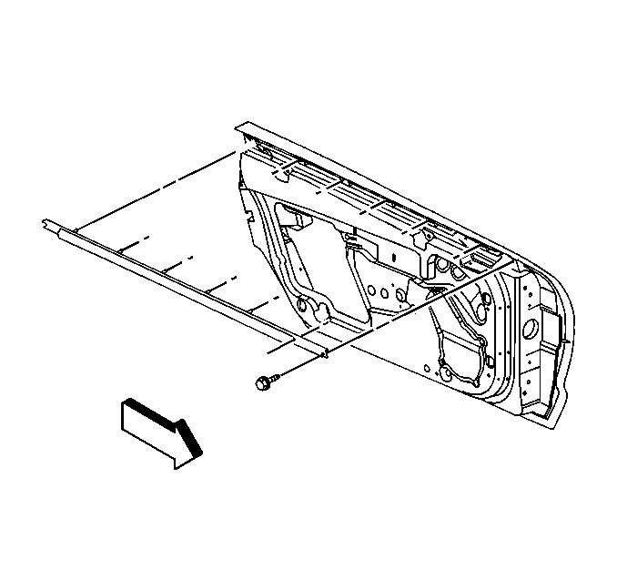

  1. Remove the door trim panel.
  2. Remove the screw from the front of the sealing strip. Slide the strip rearward.
  3. Pull the sealing strip retainers from the holes in the door.
Installation Procedure
  1. Align the sealing strip retainers to the slots in the door. Push the retainers into the slots and slide the sealing strip forward seating the retainers.
  2. Install the screw in the forward hole. Tighten Tighten the window outer sealing strip screw to 2 N·m (18 lb in).

OK, any little tricks to pulling the panel off?

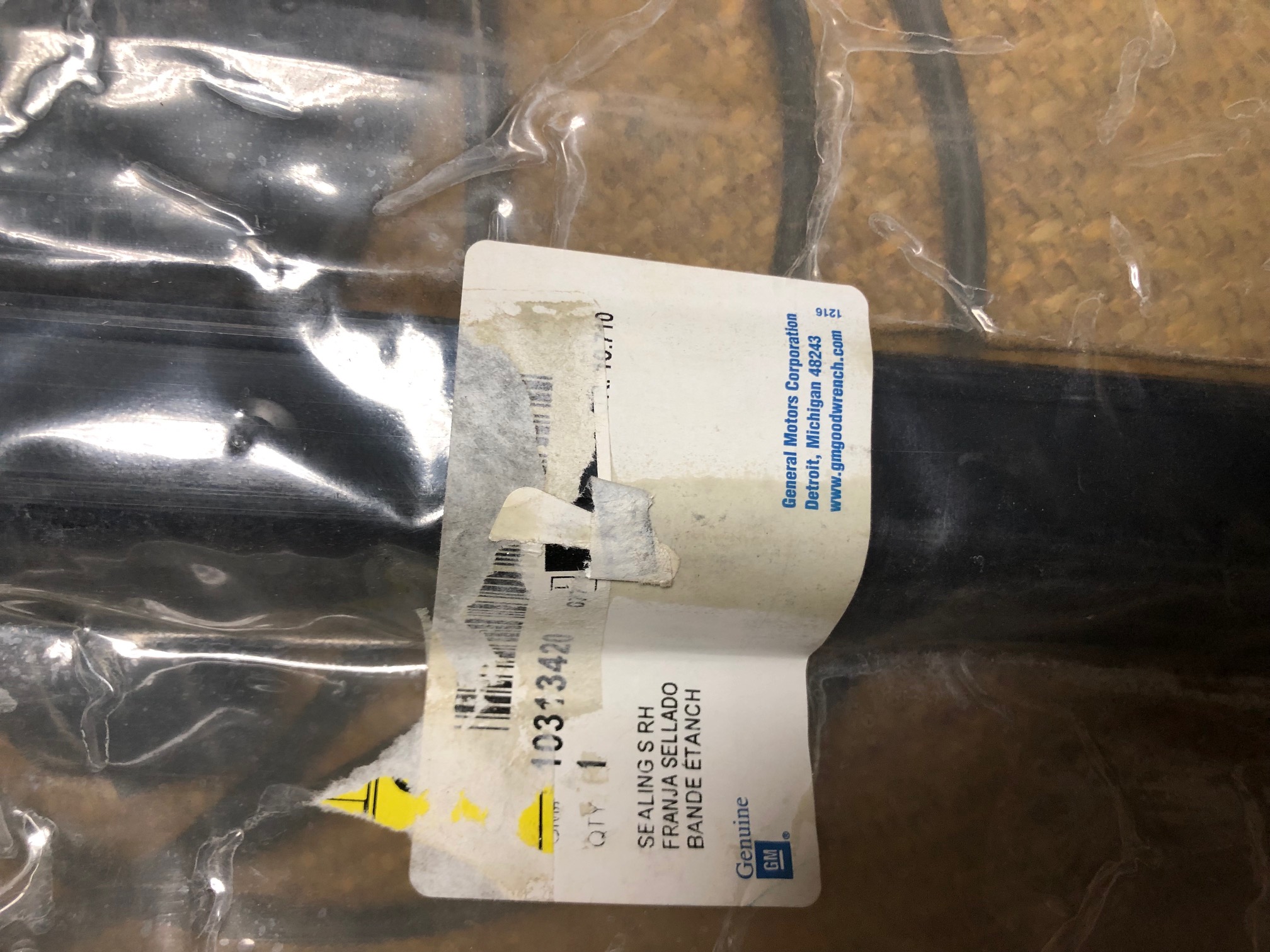

The seal I have is for the passenger side...I'm pretty sure. You are welcome to it, if you want it.
Ha, if it didn't happen yesterday I have a hard time remembering......:boogie Have you bought the seal yet? I think I still have the drivers side one. I only replaced the passenger side IIRC. I'll have to dig around and find it.
:lol: I fight that battle all the time..and no, I haven't bought the seal yet, I did notice you have to buy drivers' and passengers side, guess that makes sense..or cents..

I'm thinking back when I did that, I bought them separately....but again, that was 8 years ago. The offer is still open, you are more than welcome to the one I have. PM sent.
