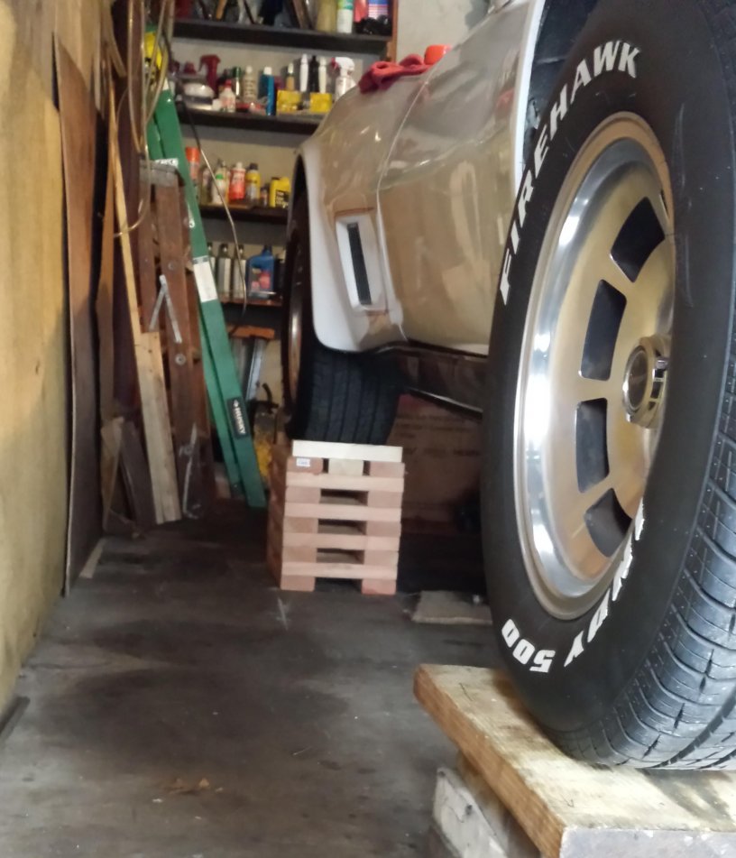

Finally made the front stands...maybe over kill but it's SOLID!
As you can see...I'm working in a 9' wide garage...very snug!
Like I said, if I can help no suspension will hang!
