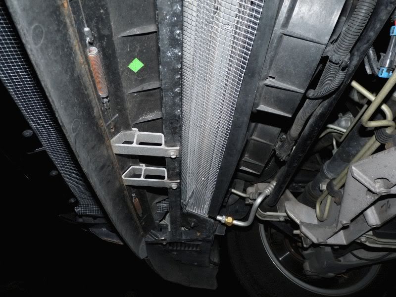

You can do this:
I got tired of vacuuming a path as I rolled into the garage in the fall :rotfl
You can get fancy by using chromed or the same screens as they sell for the visible openings but be advised that type of closer mesh blocks as much as 60% of the airflow (there is a calculator on the McMasters site that shows what flow you get from what box per inch mesh you choose). Turns out the regular 1/4 inch mesh you get at Home Depot or Lowes is a very good compromise, small enough to keep most stuff out but large enough to keep good flow (forget the numbers at the moment, I did this last fall, check McMasters before selecting mesh).

Guys, use what you want :thumb its your car, but you may want to take a look at the info on the McMasters site. Find a product they offer that is similar to what you intend to use (same thickness wire, same boxes per inch) and just take a look at the amount of flow what you intend to use will block.
I originally intended to use the exact chrome plated diamond type mesh that we commonly see in the Z06 type screens until I deduced that it would likely decrease airflow by 70% :W Im not an engineer, I made my decision based on the stats given for an apparently identical mesh I referenced on the site.
I could be wrong :upthumbs but you should take a look before you buy whatever it is you decide to use.
