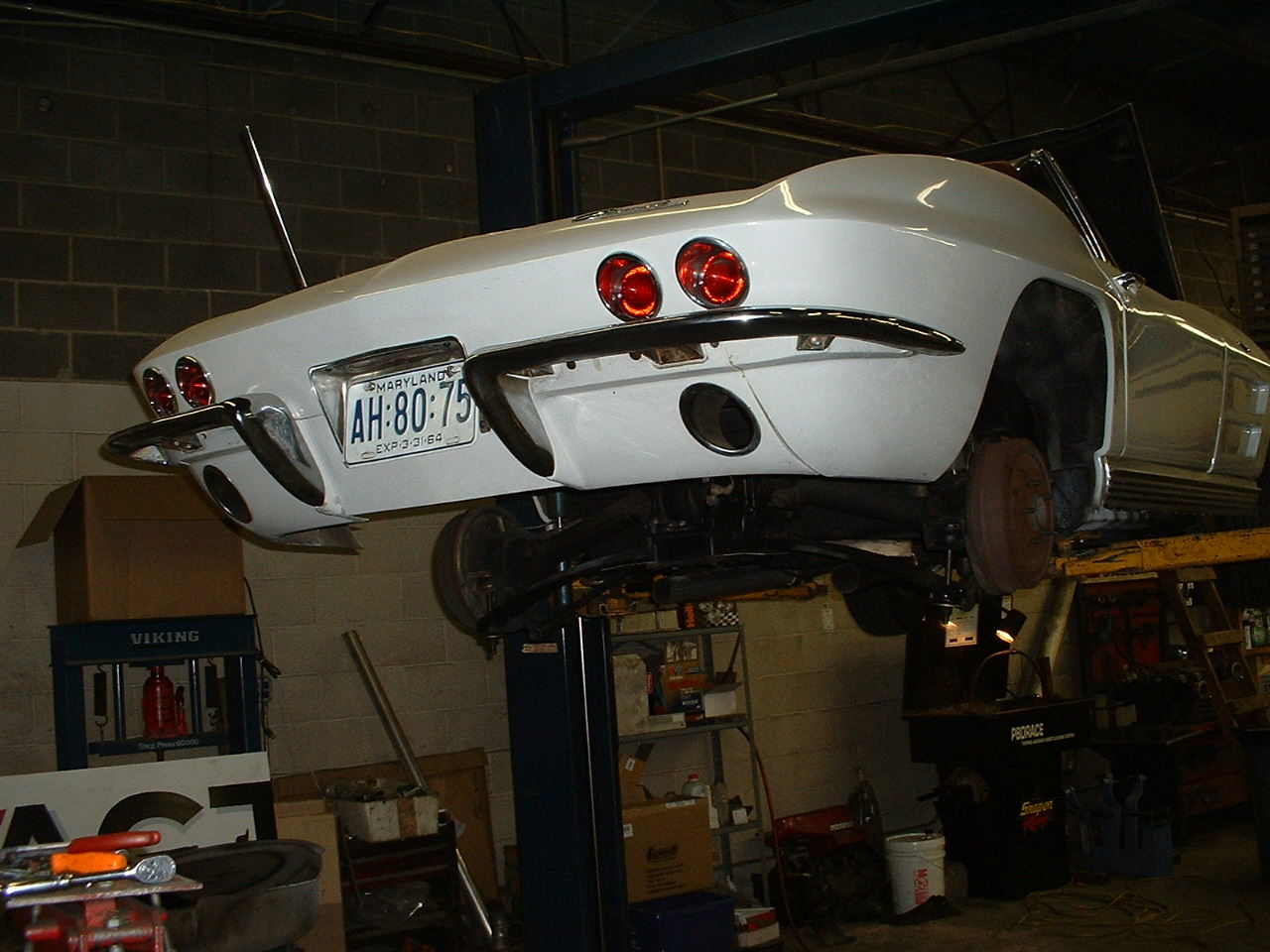

Has anyone installed a suspension kit. I was wondering if this is a job that can be done at home. I was looking at Corvette Central for parts.

Unless you have a lift I would not do it at home. As for the squeaks, after I did mine, I didn't hear any, but then I have headers and hooker mufflers, so I don't really hear much of anything.

I will be getting a 4 post lift before winter.

I can see where a lift has it's advantages in certain areas but when working on a frame that's free of bodywork I'd just as soon set on my shop stool with the car on jack stands about 1.5-2 ft. off of the ground. Standing for a period of time and reaching up kills my aging back. I have one of those formed creapers with the head rest that adjusts so I don't have to hold my head up to work and it is really quite comfy.

The body is still on my car. As for the lift i require a four post lift so i can get my truck
inside for the winter. Good idea about the creeper.

Installed a VBP kit at home, on jack stands, body on. Took a week vacation and got it done no problem. The hardest part was rebuilding the front control arms. :beer
Bushings
Sky65; I also did all the bushings at home on jack stands, I would think that a 4 post will get in the way, may be just me. I installed rubber all the way around, the old ones lasted 40 years and I only need them for aprox. 20 years. :pat
