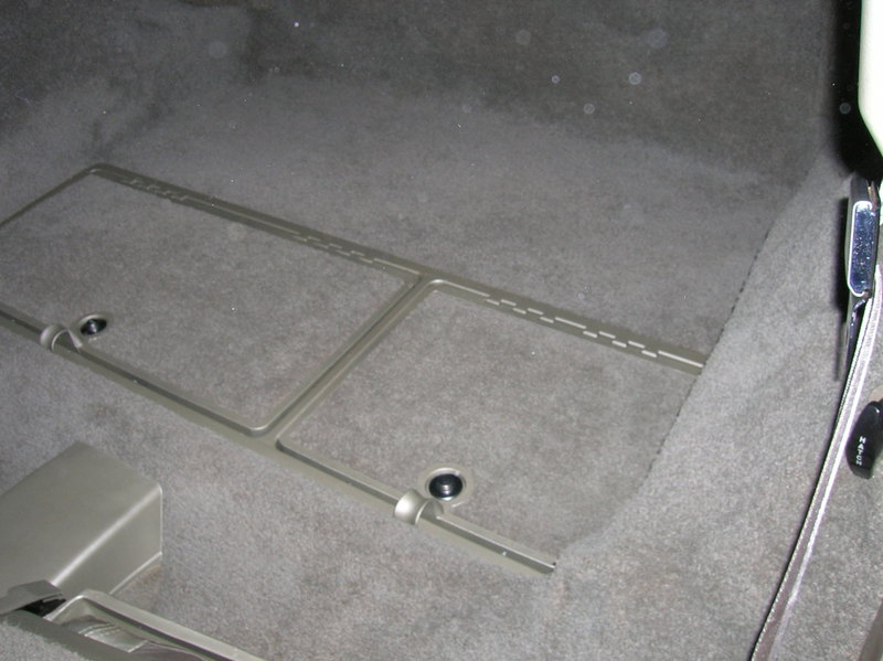

You can replace just the frame work around the doors and the large frame. You will have to paint to match and do some fitment of the frames to the doors and get some small screws or glue to reattach the frame to the doors as they were glued on with heat from the factory. You keep your old doors and carpet. You just break off the old trim and clean up were it was glued on you will need to file or sand the edges of the doors to get a nice fit of the new trim, do not force it on they will break. One the fit is good paint to match and install. I've done 5 of the 7 C3's I've had this way.
C3 Corvette Rear Storage Compartment Trim 1979L-1982 2 Door - Mid America Motorworks
http://content.mamotorworks.com/pdf/602453.pdf
My CE after I was done kept all the original carpet.
Steve, thanks. I appreciate that.. Mhhh. Now i know what is involved. Breaking off the frame, that i can do. I happen to have a small bottle of Silver Beige leftover. Might just work for only the doors and large frame outside.. I'll keep this handy and will prolly go with the frames only job. That way i can keep the old crusty carpet crusty. :)
