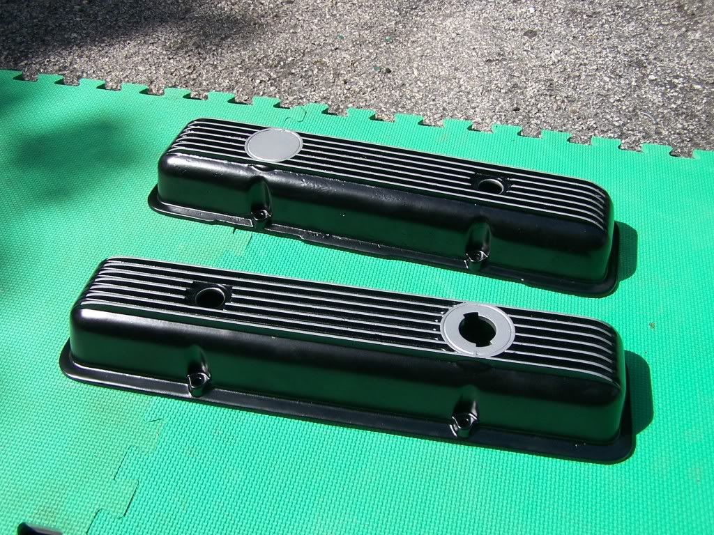

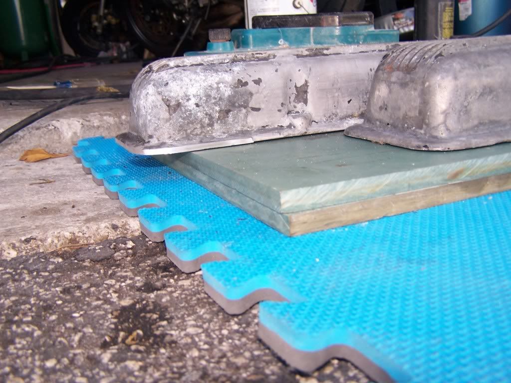

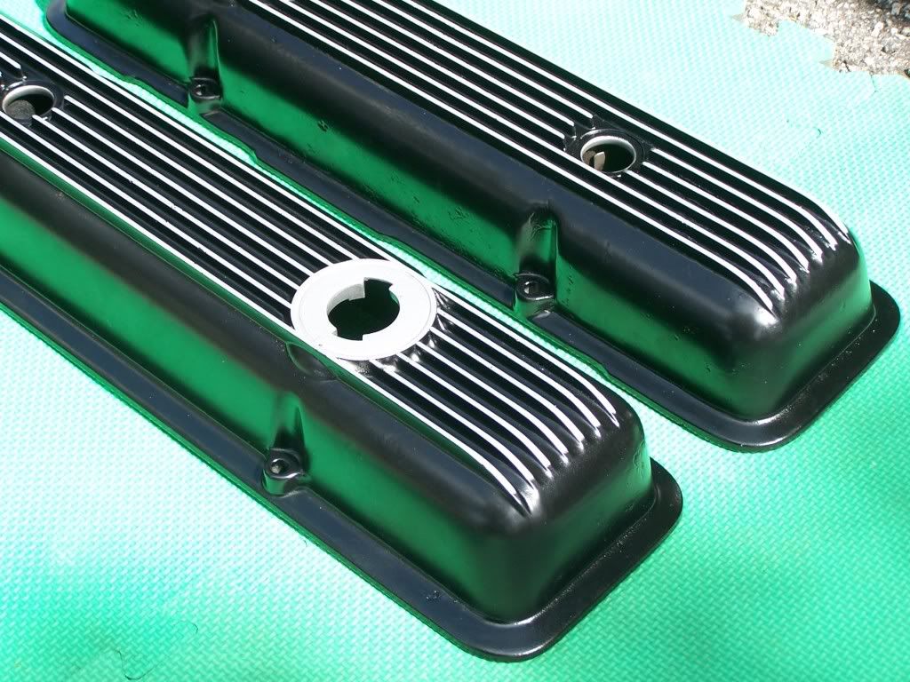

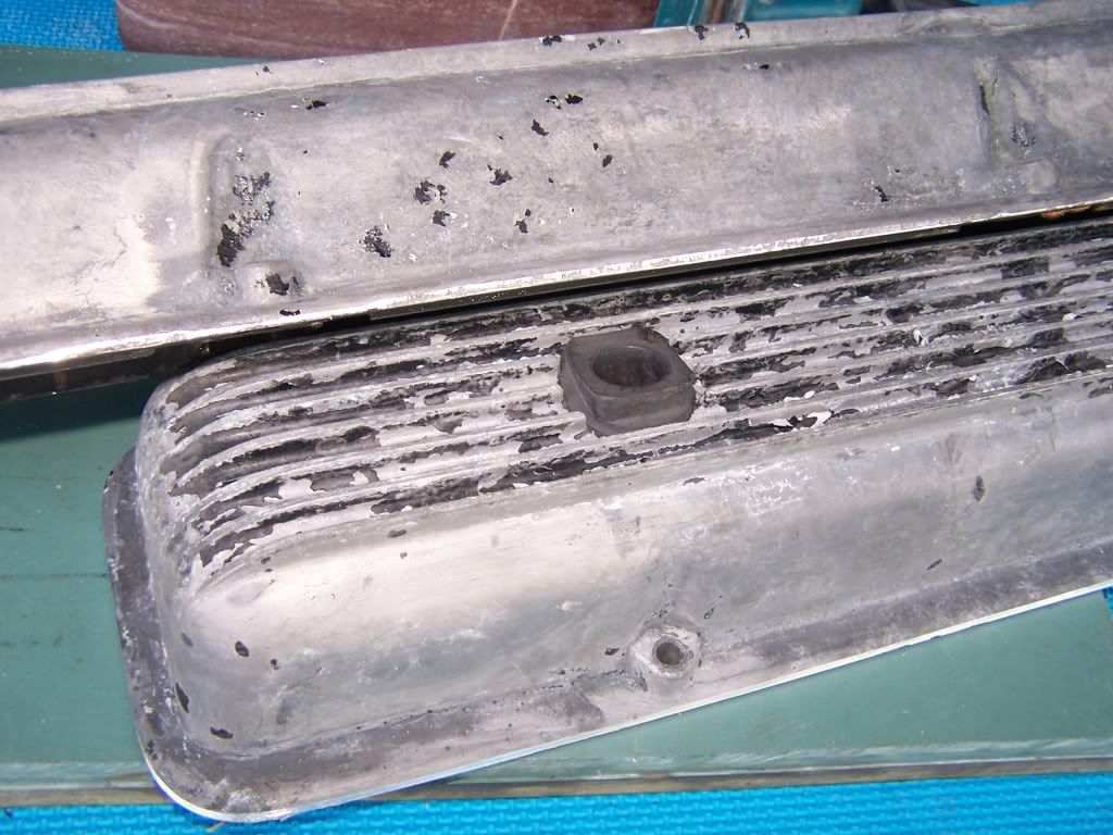

my valve covers. they have been squared off on the crappy cast edges and smoothed out the excessive cast marks. the right side cover was really nice and the left side looks like it has been rolled in nuts and honey before it was cast.
Very nice! And without the paint they looked the same as mine did.
