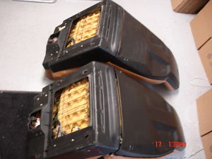

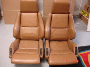

new seats.jpgvette seats.jpg Here they are!
I know what you mean about scoring big. I have been looking at all my options and had decided on new foams and covers. Then I stumbled on these. I saved HUGE $$$$ :thumb And they match my cars interior code.
The $250 included $100 shipping charge! :chuckle
I've taken my old ones out MANY times to retrive stray lighters, keys and etc. so I know that drill. Your instructions are really helpful about all the rest. I'm printing them out right now and will head out to the garage tomorrow to put 'em in.
Thanks a TON Boom. :beer:beer:beer
