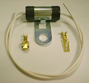

I have a 1990 coupe and I need to find out where the tach filter is located. This is my first time on the forum and also my first corvette. Somebody help me.
Look at the distributor cap on the driver side. You'll see two wires with push on connectors near the bottom edge of the cap. One I believe is Red or Pink and is 12 volts. The other one is White and is the wire if you follow it leads to the tach filter.
Here's a pic. of what it looks like. The tach filter bracket is held in place by one of the transmission to engine bell housing bolts.
