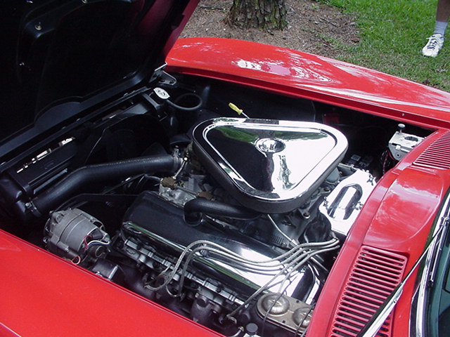

Hey Larry,
Heres a pic of a 502 w/a 400hp tripower set up I did a few years back in a 67. looked and ran great!
