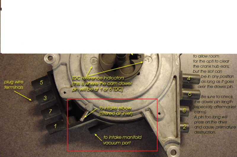

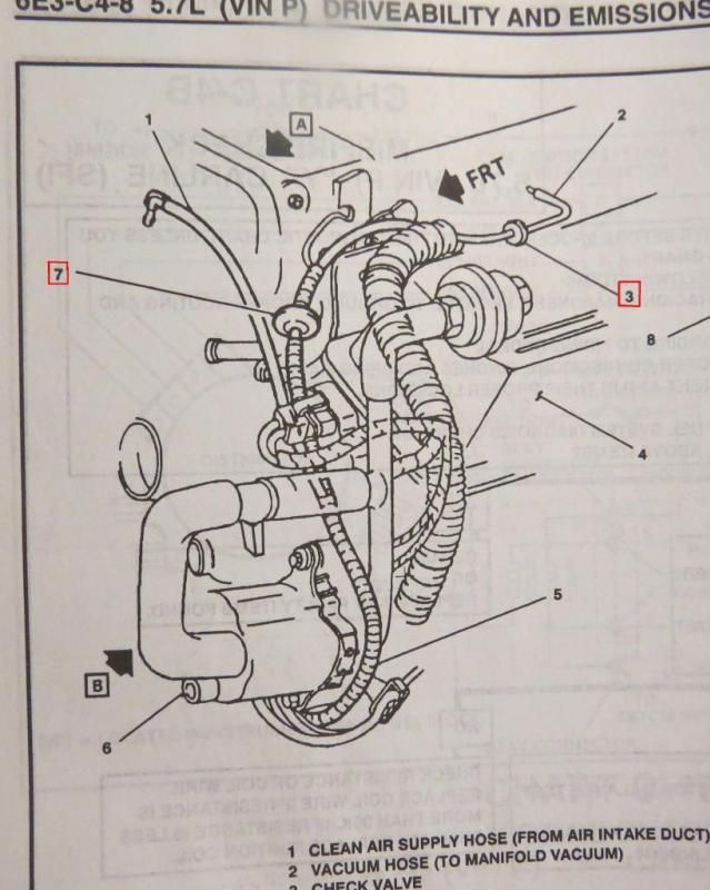

Just replaced the water pump, distributor, etc. on my '96 LT-4. When I was taking the water pump off, there were two vacuum lines running down the left (drivers) side of the pump. One goes to the distributor and the other goes down below the pump. It came off when I was removing the bolts. Now I can't figure out where it hooks to. Does anyone know? It looks like it slips straight on to a pipe somewhere.
Also, now the engine starts but barely runs - do you think the loose line may be causing that? Everything else looks good (wiring, timing, etc.)
