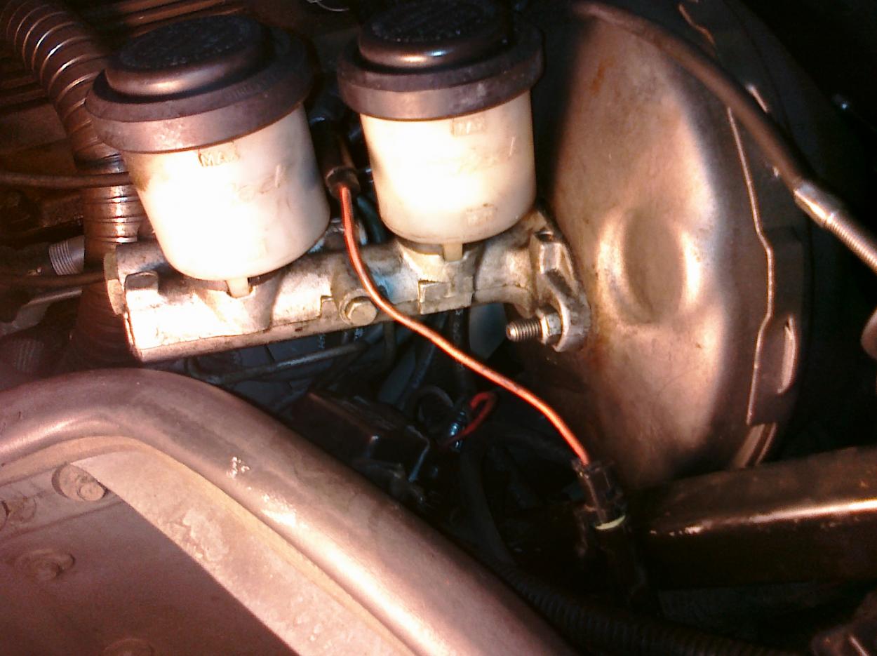

vettecable.jpgThree things:
1. My instrument panel had only half of it's light working, after my wiring pulling fiasco, all lights are on, even when the car went dead on me.
2. I took out the fuel pump regulator, and it still runs great!
3. What is this wire coming from the battery (having running through brake cylinder so you can see). If I disconnect it, the injectors don't fire.

Your odd wire...probably a replacement for a dead circuit. Look at the ECM and at the bulkhead seal for a wire thats been cut off. See where it ends up...spliced into something.
For whatever reason somebody felt it necessary to run a new path for a power or ground circuit. You have a series of power circuits that are NOT fused, that are on a bolt behind the battery called the "jumping post". That post supplies the power for all the critical system and has fusable links under the battery that do NOT run thru the fuse panel. It may have come from there originally. I've seen lots of jury rigged wire when a fusable link blows and nobody can find it.....they usually just run a new wire.
As far as the dying...look at the wires to the dist and find one thats got bad insulation or loose. They will ground on something and short out the ing system. The wires inside the cap get pinched and the module gets shorted out.
That wire might even be a bubba style VATS bypass of some sort. Thinking that supplying power to the vats module will eliminate it and allow the sure starting of the car. All it takes is a 4" jumper wire in the right place, but I can see bubba running a wire from the battery to the decoder module if thats what was cutting off inj signals. Sure would be nice if barnyard engineers would leave a diagram behind with thier handywork.
