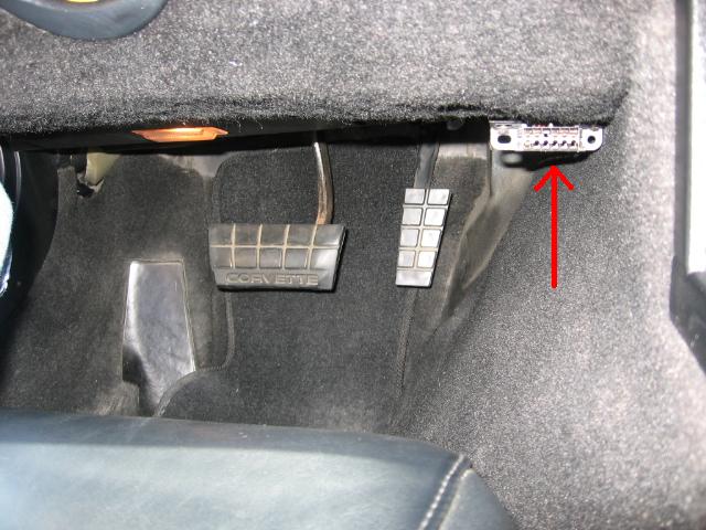

With your DVM set on Ohm's , a fresh fuse in and the wiring at pump disconnectedI found a diagnostic chart on autozone's website. It says to probe the ALCL connector terminal "G"
How do I test it?
It'l work just fine!The diagnostics actually says to do a light test. I tried using the A terminal for ground and got no reading. I got nothing whether the fuel pump was connected or not. It was suggesting if the light comes on then it means there is a short in the circuit. If there is no light then it could be an intermittant short in the circuit or a bad fp. I tried your 'ohm' test and did get a reading with the fp disconnected.

Test light should have lit up when Terminal A probed ( light direct to ground ); does test light work correctly?I tried using the A terminal for ground and got no reading.
That would indicate to me you have a short in the wiring before the tank connectorI tried your 'ohm' test and did get a reading with the fp disconnected.
