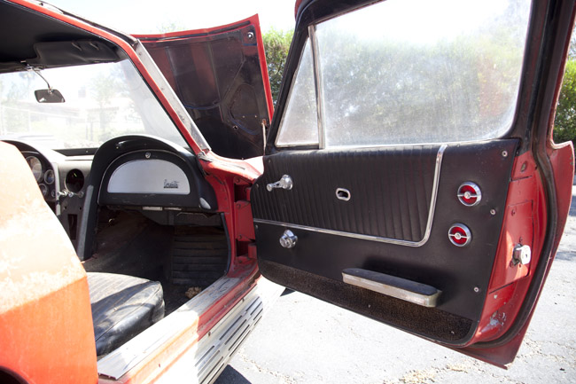

1963 Split Rear Window that needs a lot of work.
I have a 63 split rear window that has been sitting in the garage in a state of disrepair for about 30 years. I love the potential the car has and have many of the original parts (shifter, radio, clock). I have no idea how much work it will take but I know I can't do it myself. Need to find someone/someplace that will give me a rough estimate on whether I should just part it out or whether it could be put back together again. I do not want a show car. I want a nice drivable car. I believe the frame and suspension part are actually OK and not rusted through but it obviously needs work. If anyone has suggestions I would like to hear them. i am just starting research on what to do with this car. I am in San Diego. Here are a few photos. Thanks in advance for any help.

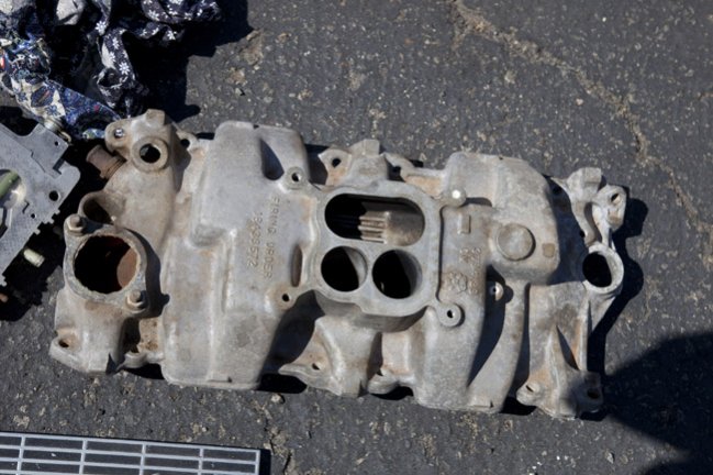

The number on the intake manifold on the ground is 3794129 which I believe does NOT correspond to a 63 year engine. Don't know the number on the engine in the car. Will look for Trim info next time I see the car.

I have another intake, as mentioned, with number 3794129

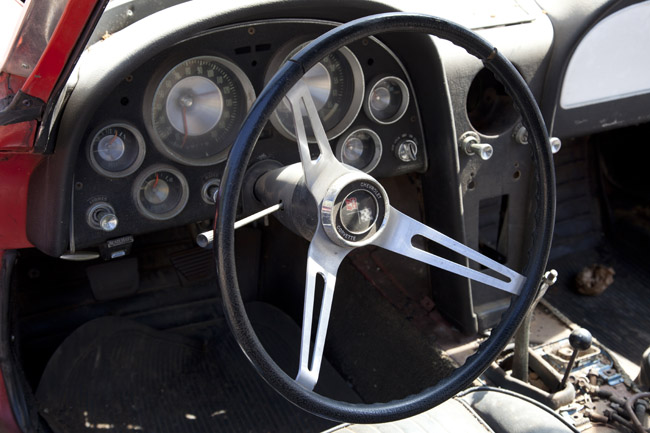

It's worth the money to restore, and if it has the original drivetrain, it's REALY worth the money and trouble. It appears that it is mostly all there. That makes restoration a matter of eBay stalking and a swap meet or two. Other common restoration parts are easy to find on the aftermarket
First find out about the drivetrain. Check out the NCRS boys in your hood for some help on that, and other issues. We'll help where we can ,but ya kinda gotta be there.
With the start you have, that will be a fun and rewarding project.

Based on the pic's, absolutely! Looks like an original and wouldn't be surprised if that is the original drive line. If it is you have a big winner! Also, has the body ever been hit, do you have any documentation on the car? I would love to have this car for a project. :happyanim:

Well, here is a picture of the other intake manifold I have. Maybe it is the original that came with the car.

Nope, that's not a Corvette intake manifold; it's GM, but not Corvette.
