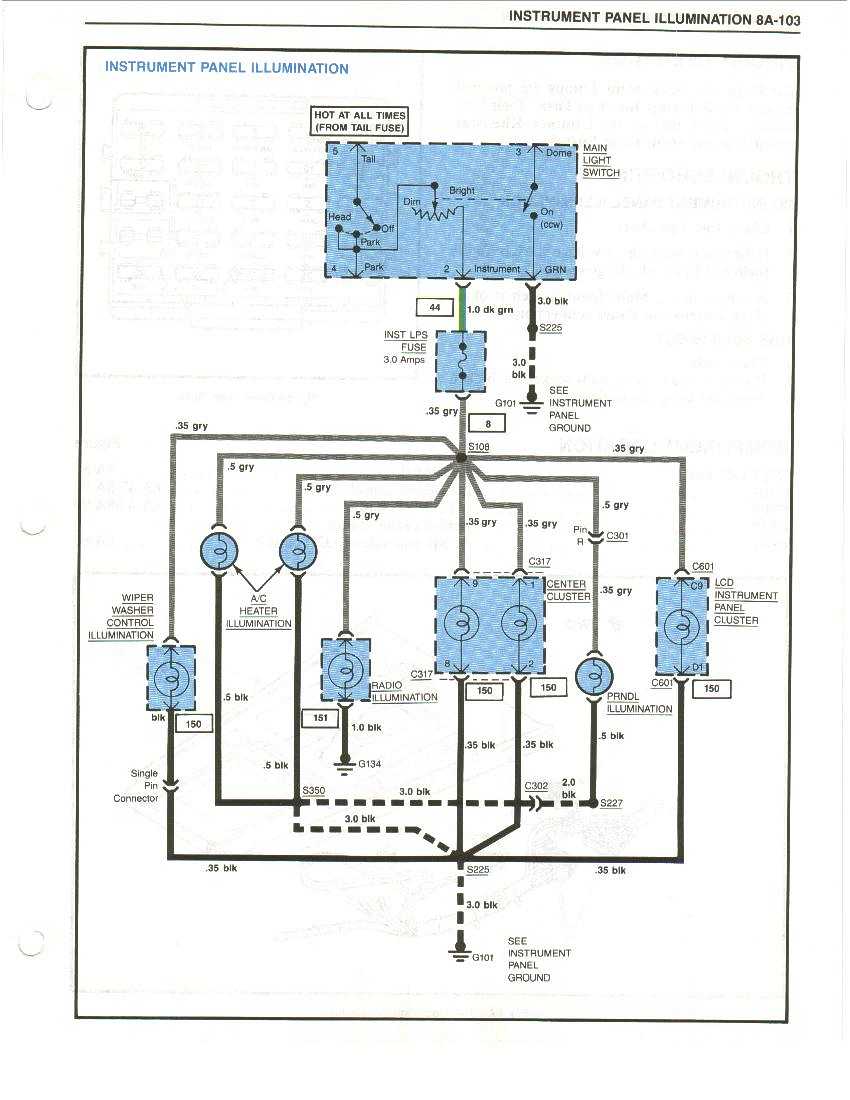

Fixed It
I was also having issues with the center radio/ac clusterback lights and the lcd dimmer switch not working, didn't think these could berelated to the fuel/not starting issue. (Needless to say, I had checked all thefuses I thought could possibly be the culprit) After looking at the superdetailed illumination electrical schematics and the ignition switch powerdistribution schematic I realized the gauges fuse is somehow connected to thetail fuse and powers the tps sensor so I checked the tail fuse and sure enoughblown...Been riding around for a week without tail lights and didn't even knowit. Never would have thought the tail light fuse would have caused this manyissues. Sure glad I didn't start tearing into something over a fuse. It starts right up and everything is lit, thank you all :) Bizarre
