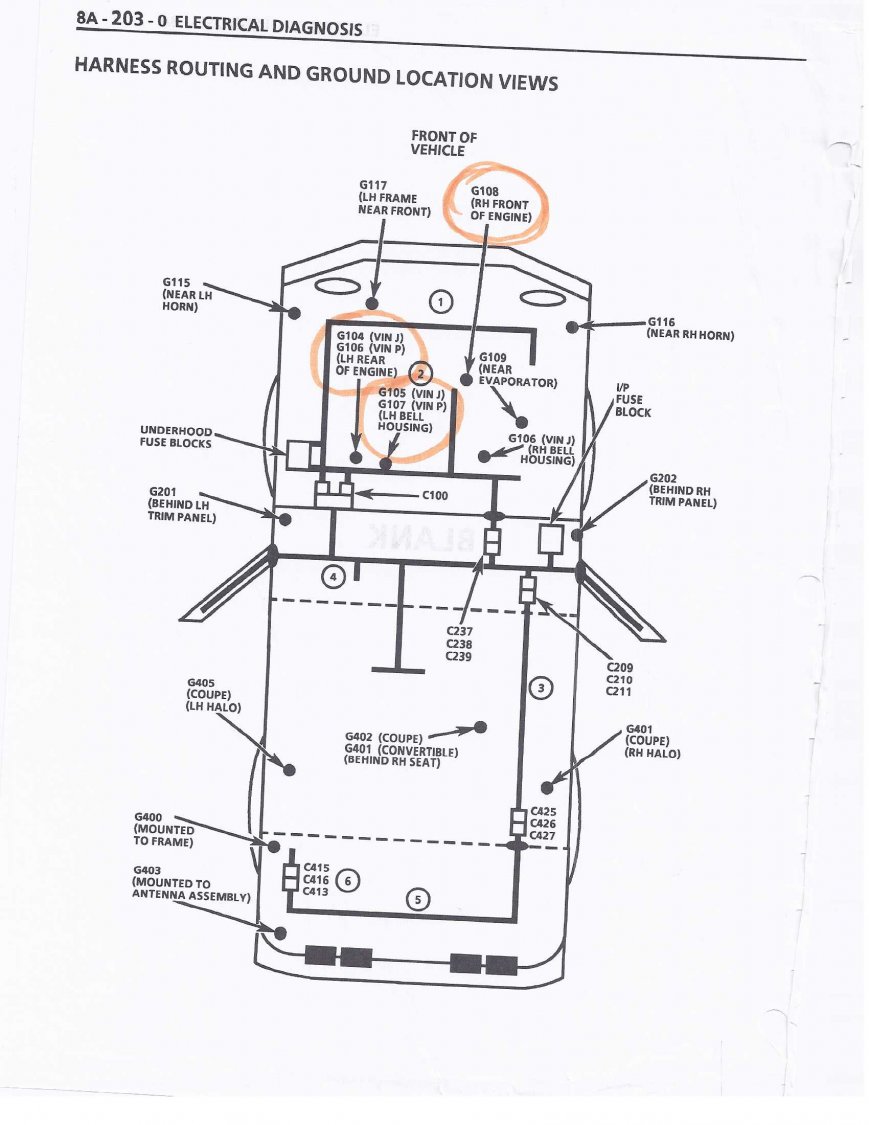

I hope you have fixed the problem. Just for something to do when it is running shake and move all the wires from the TPS, MAP etc that go in the wiring bundle. While doing that listen for the engine to change or quit running. If it does than start to follow the wires back into the large wiring harness until you find the large bundel of ground wires that are all connected together. If that bundle is corroded take the wires and seperate them and then do a continuity check back to the connector(DO NOT BACKPROBE TO THE ECM). That will verify they are not broken between the connector and the ground. Strip the wires to get new clean wire and reconnect them using solder. Finally recover the bundle with either electrical tape or use the liquid tape to cover them up. Now that you are already working on the car and the hood is up it is a good time to clean the rest of the grounds. The chart am showing you is from my 93 manual but you get the picture.
The important ones are the frame rails and the bell housing grounds since they are the ones for grounding the wiring for the engine. The grounds not in the engine bay are for electrical things like lights etc. I again hope you have solved your problem but if not this is the next step to follow. As for the grounds needing cleaning that is something that needs doing just like an oil change. Except this is every 10 years or so. Storage and moisture quickly seep into the grounds and they lose there effectiveness. The more you work on the car the more you will come to realize the grounds are the lifeblood of a Corvette.
