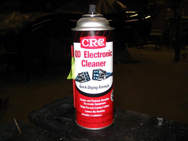

What is the best way to clean out the lock mechinism?

Clean it with alcohol and a Q tip. Just be sure not to get the alcohol on everything, plastics especially. Like I said, its pretty forgiving. I just douched mine with LockEase because the switch was sticking, and the VATS has not acted up one bit. More than likely IF there is a VATS problem, its in the starter enable relay or module.
