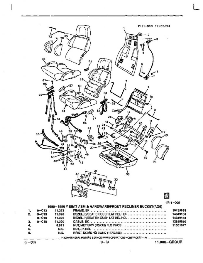

Found parts schematic; will see if I can find wiring schema here...
attachment.php
I did not get a chance to get the actual wiring diagram; is THAT what you're needing? Or is the parts schematic got it?

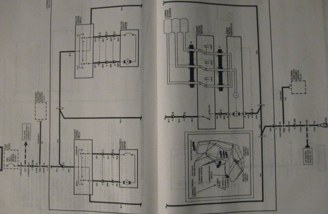

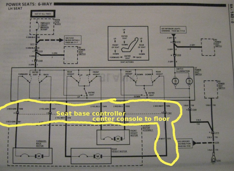

Thanks for the diagrams Schade! They are coming in quite handy. Ill have to pick up a FSM when i get a chance.
