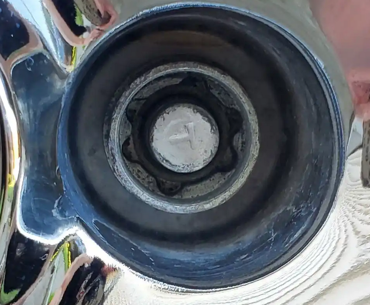

Hello im going on on a limb here basically since it seems questions on here dont get answered anymore well at least the last few i posted didn't , so i am hoping someone might now what this is i have a locking wheel lug on my corvette that didn't come with a key to remove it when i bought it and im not sure what kind it is , i been to many local tire places to ask for help to remove them but no one has seen this type or have a key to help out , they have been telling me that the lug will need to be drilled out and replace which will cost some pretty good money, please let me know if anyone out there has seen one of these lugs before and what they might be called and maybe where to order a key from? thanks in advance
That one sure is different. How did you get it off?

Mid 70's I bought a 71 Vette that had wheel locks and no key. I worked for an earth moving company and the head mechanic said bring it here Saturday. He sticks a big chisel in the pattern, smacks it with the hammer 2-3 times and then turned it out with channel locks.
Sometimes you just have to show these locking lug nuts who's the boss.
Tom
Most auto parts places have a tapered socket that fits over the lug and has teeth that grab into the metal. Put it on an impact wrench and press hard and comes right off! A near size 12 point socket will also do to if you hammer it a few times and the hit it with an impact wrench. Real crooks can take them off, the amateurs are all that you are protected from! They are a waste of money!
