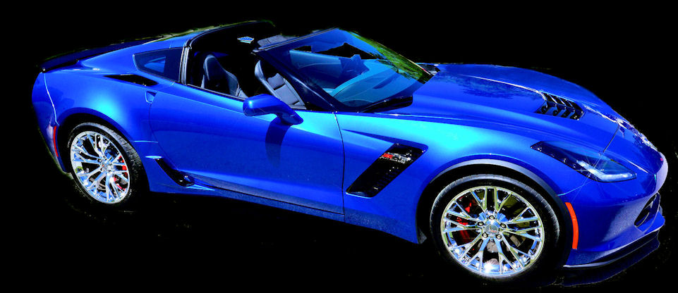

After tracking my Z06 at the NCM track for a couple of days, Corvette at NCM - a Z51 vs Z06, I drove 600 miles home. Right around 100 miles before arriving and with no bumps or abnormal road conditions noted, the car started rocking sideways when hitting undulations in the road (bumps or humps in the road that lifted the car up causing it to settle heavily on the suspension). It was first noticeable as my head began swinging from side to side rather than just fore and aft when the car lifted and settled. It was not only noticeable but very uncomfortable. The front of the car would inscribe a figure 8 as the car seemed to settle more heavily in the left rear, be pushed toward the right front, left front, and right rear. Over normal bumps (where only or 2 wheels hit the bump) the car is normal and not upset at all. My local GM mechanic who has been 'pit crew' on my C7's for three years now noticed it right away.
He changed the rear magnetic shocks with no change - problem still there. When it happens, the car bounces around from corner to corner of the frame and it is annoying plus it upsets the car a lot. It is much less noticeable in Sport with the magnetic shocks stiffened and barely discernible in Track mode. Careful inspection underneath shows no apparent problems, leaks, or noises.
The problem started with a normal Z06 alignment (less than 24 hours old) and continued with a racing alignment as per the specs in the owners manual. I am beginning to suspect the fiberglass leaf spring although it appears normal. Any ideas? I want to track the car again...
