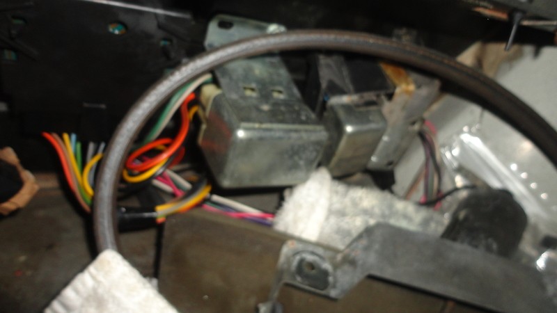

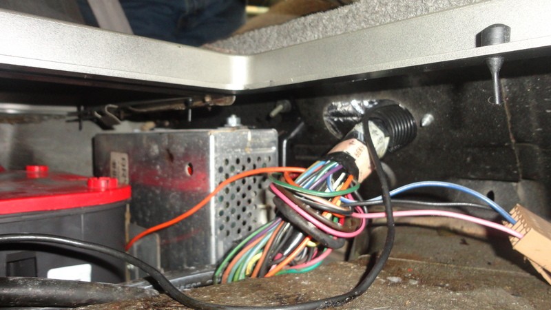

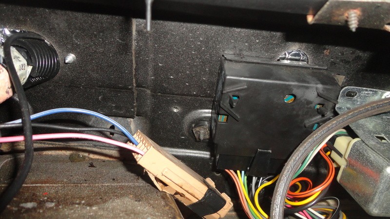

Not the best pics but hope it helps
The big silver box behind the battery is the ECM (Computer) Really don't remember the others but I'll see what I can find. If need better pics let me know I'll get some. The large silver one on the right center I think is the anti-theft relay, one may be a fuel pump relay??

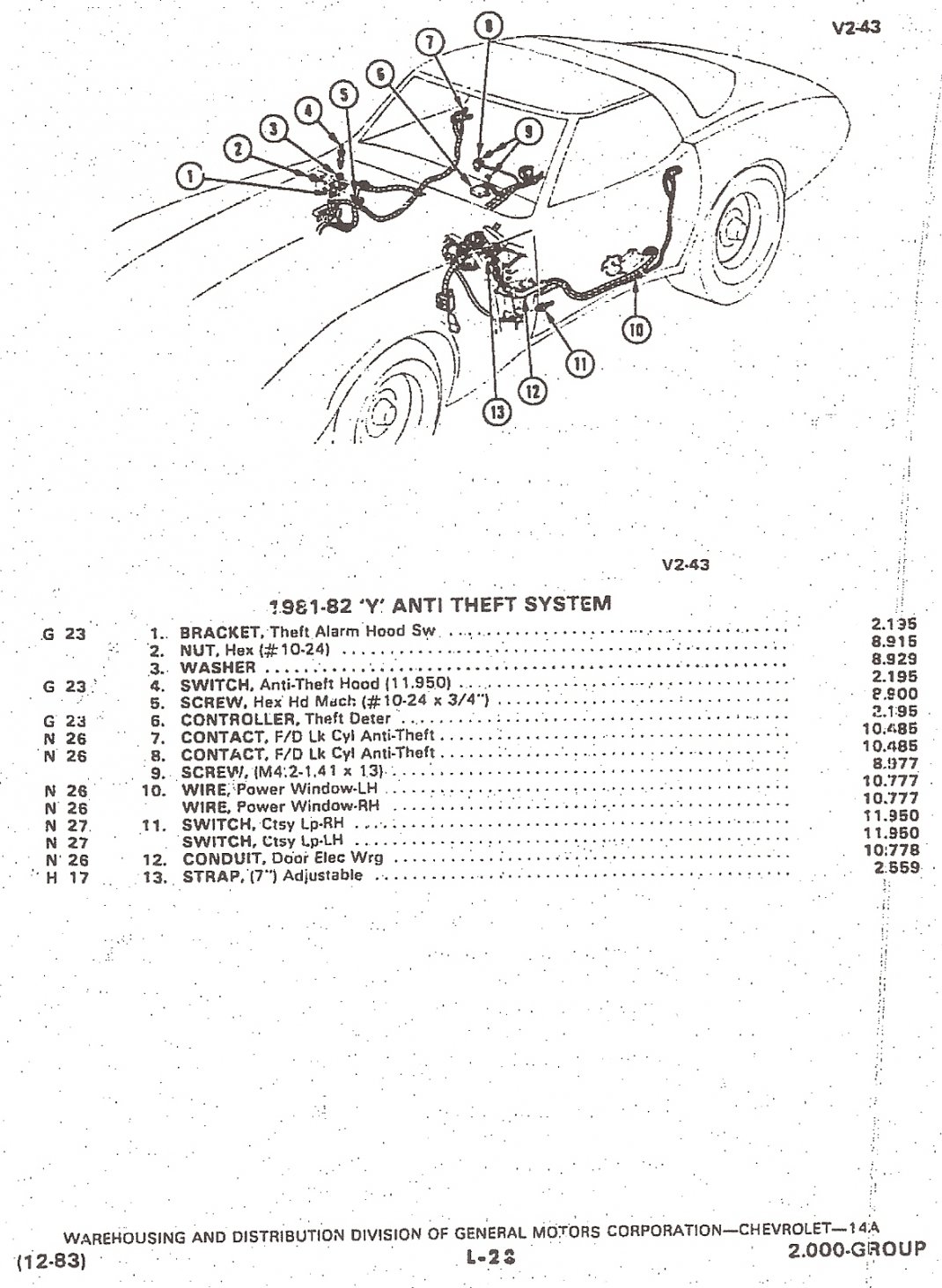

Behind the passenger seat is the anti-theft module (black) and the silver on the right is the intermittent wiper module.
On the 81, the centre silver unit is the relay for the power antenna. May have changed for the 82, but don't see why it would have.
