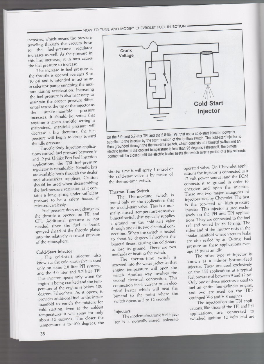

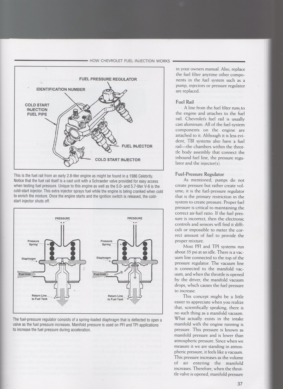

I know my '90 doesn't have the cold start valve system, but I thought the pre 1990's did. Here are a few pages from an TPI book I have. img032.jpgimg033.jpg
