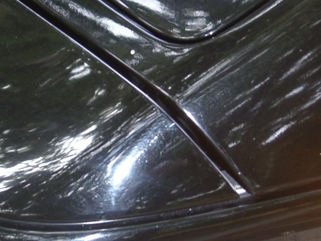

Would anyone of you have pics of the alignment bolts that
adjust the spacing between the hood & the part of the facia
in question? See urls/pics below. Thanks
http://i256.photobucket.com/albums/hh178/DonneTrav/01010097.jpg
Need advice on alignment of the bumper & hood on my '94 LT1.
Please see pix:
Please see pix:

Did you get the bumper corner / hood corner to align? If so how? I have the same problem on my 94

This is tricky and a job for a pro body guy, methinks. I worked with Jerri for many hours to get it right and HE is the pro. This AFTER another professional almost got it right. Get it wrong and you have ugly spaces and/or paint chips.
The bolts use spacers, but the sides involve some professional techniques that I cannot recall, outside of loosening and moving the inner wheel wells.

Yep...if you notice, everything is slotted, so it can be adjusted. No single panel has an exact fit, you get it close then adjust everything around it to match..

When I got my car back from the paint shop a few years ago, I had the same problem... the hood and front bumper were not aligned correctly.
It took me most of the day to get it right, but everything finally lined up to my satisfaction. Most of the alignment came from adjusting the hood, not the front "bumper" assembly.
Small incremental changes it what it takes. I also had to re-align the latches where the hood closes. There are three points to consider when aligning the hood - the continuous gap across the front of the hood / bumper and the gap between the hood and drivers door / passenger door.

mu solution was to remove the headlights so you can close and adjust the hood with it aligned. its a pain , must use rachet wreches but it finallyo worked for me
