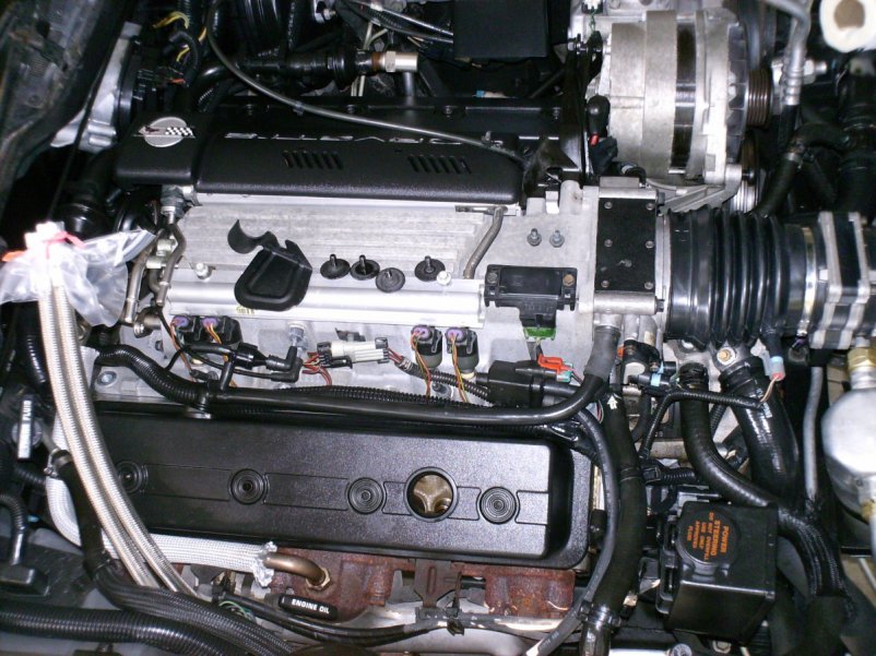

Does anyone out there have pics of exactly where the "MAP Sensor" is
located on the '94 LT1? I have gotten conflicting info and still don't know
where to look or what the piece looks like. Thanks ;shrug
IF I remember correctly, it's on the right side of the plenum, just behind the throttle body. Black, 1" x 3", green probe sits in the side in the plenum.
Don't worry, if I'm wrong, someone will let ME know pretty quick. :L
I got a pic from my '94 somewhere; I'll see if I can find it in one of these pc's...
Found the pic; it's in the center, just behind the TB (that is, IF it's the sensor SEE SIGLINE)

by jove, i think i've got! "the gold in cacaki!!
Thanks schrade!

You're welcome Sir...
