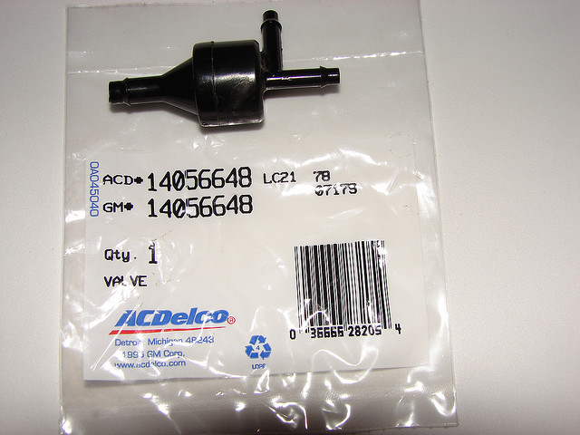

You don't mention checking the vacuum. Here is a check valve that is famous for breaking the connectors off.
One vacuum line goes to the cruise and the other goes to the ac/heater controls.
On the 96 blend door it is operated by an electric actuator, but I checked the vacuum since I was there and it was "OK". Thanks for the advice. Everything seems to function, with the exception of the blend door.
