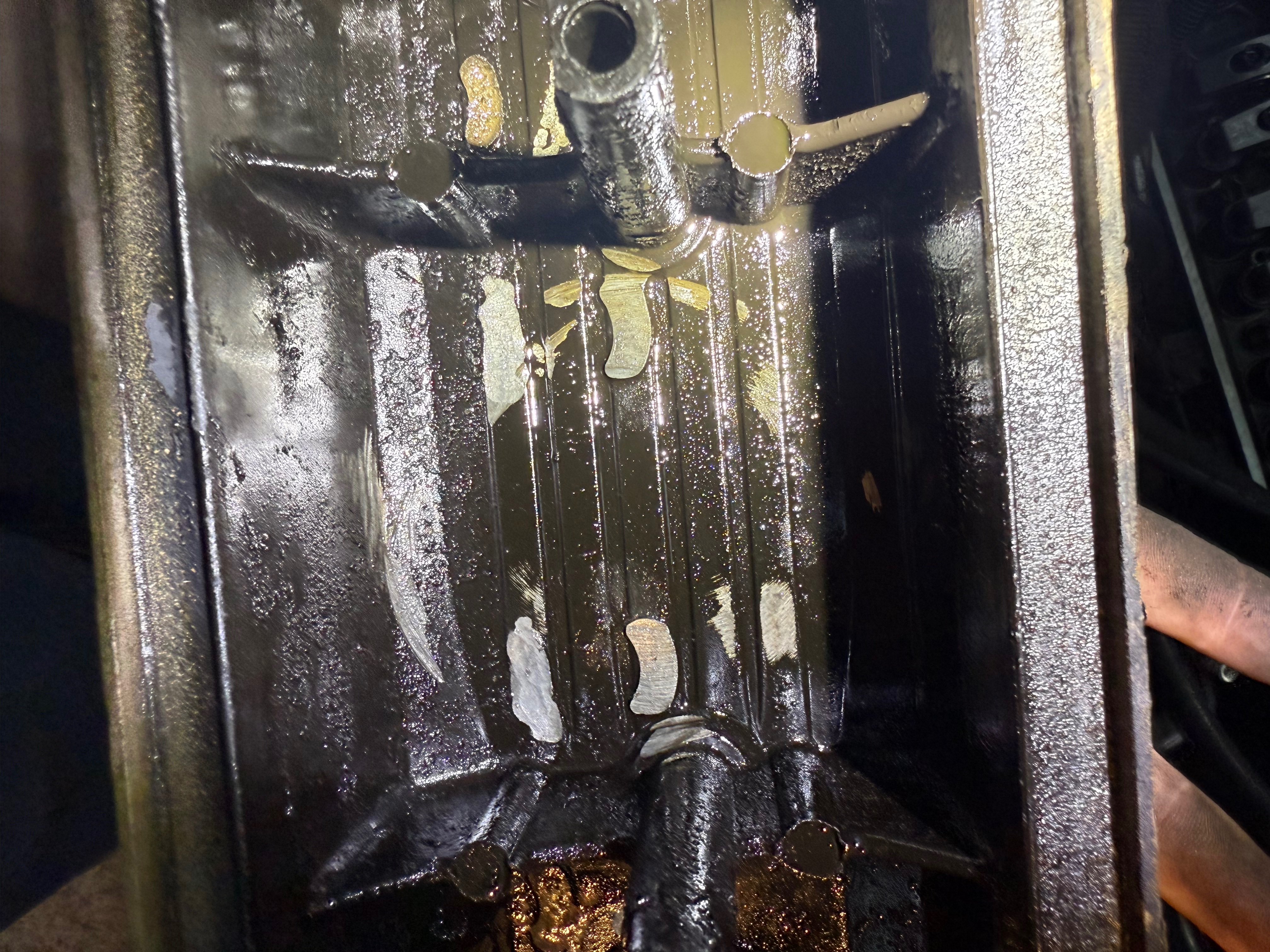

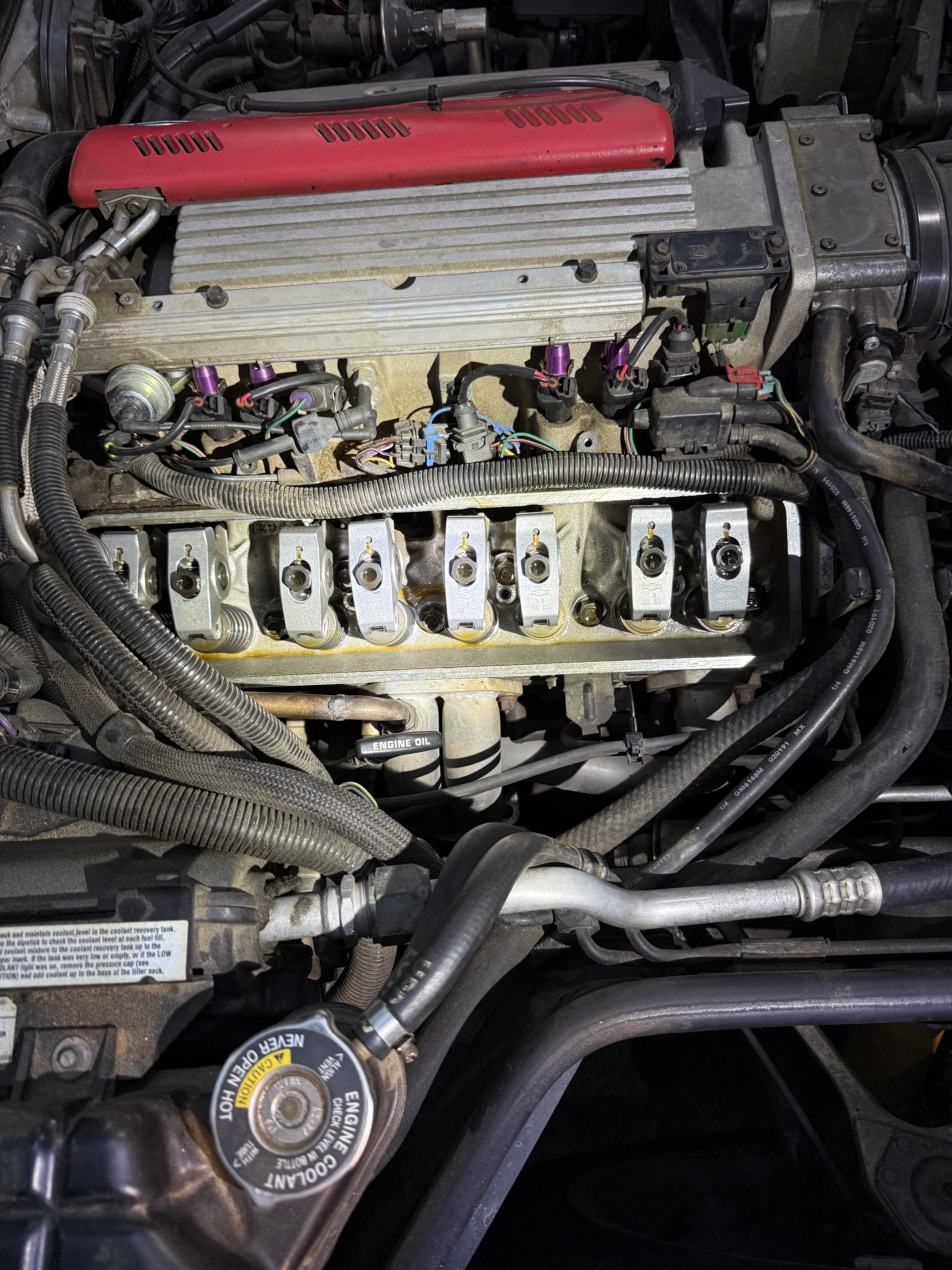

Update: I took off the valve cover like you suggested and was very surprised. I'll attach pictures and videos of course, but I discovered that I have aftermarket rockers that are bigger and smacking the top of my stock valve covers. I am going to order deeper valve covers and replace the gaskets while im at it, but wanted to know what you think? Also, I bought this car thinking it was stock other than exhaust so I have no idea what has been done other than rockers and injectors (which I just now discovered). Maybe a moderate cam but to me it doesnt really sound like it. Thank you very much for the help and I'll update again once I get my new valve covers.

Sounds like the noise went away with the valve cover off. It also looks like they have been hitting the valve cover. Do you have any noticeably loose rockers or rocker studs?
No, passenger side all seemed good but I'll have to check the driver side as well when I get my new covers.
