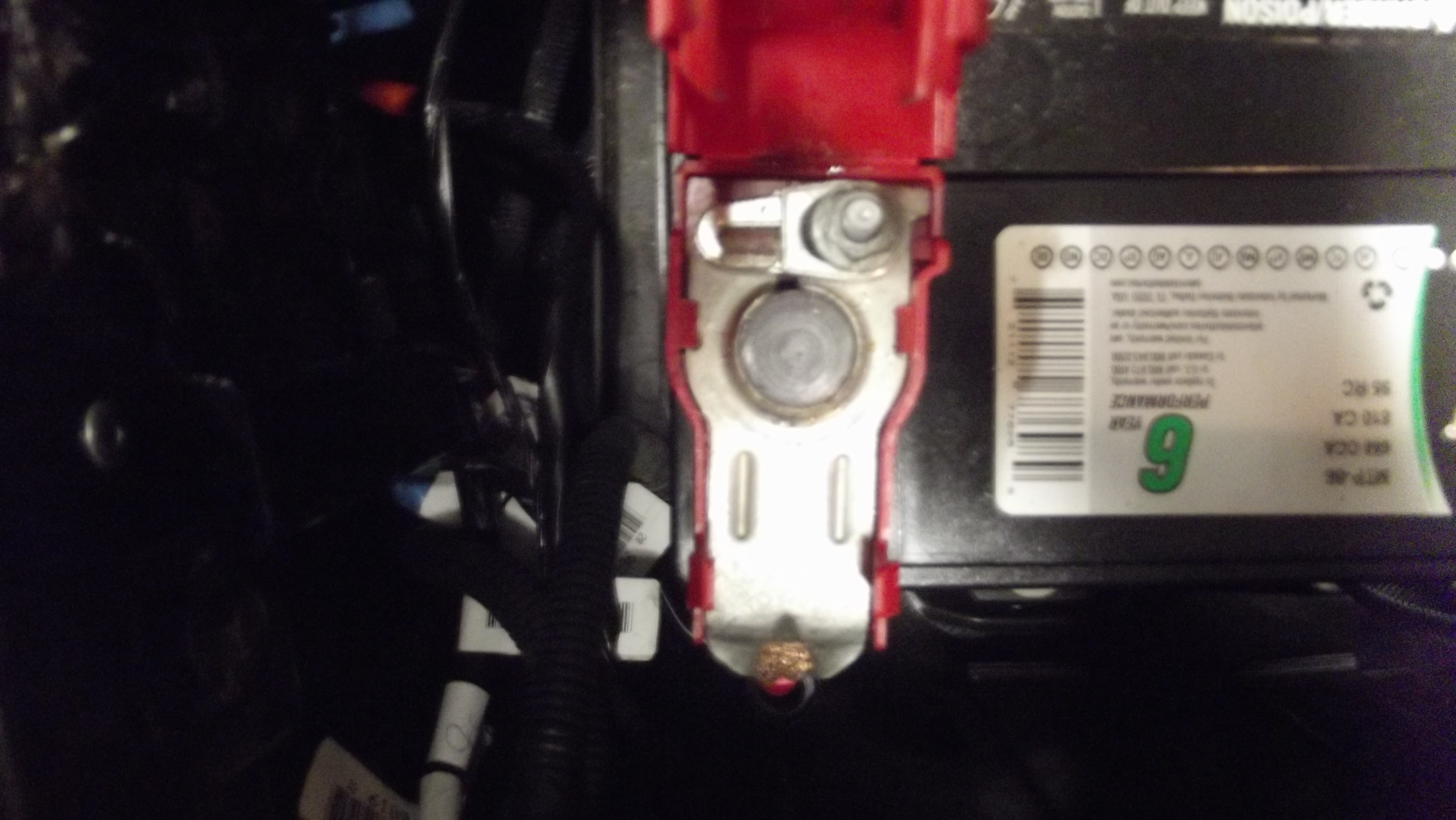

Battery connection. Have never seen a connection of this type. Would like some help on removing. I think I know how it attaches, but not sure & don't want to mess something up. Thank you.

I have never seen one like that, but I would first remove the negative cable, and then loosen the nut in the photo and twist the cable off.
My 2010 Sierra has the same cables. It's just the way they are now. As already suggested, remove negative lead first. It is just too easy to slip with the wrench and end up welding the wrench to any nearby metal when working on positive post. A good habit to form.
Thanks for the reply. Will make sure no sparks fly.
